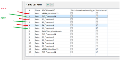

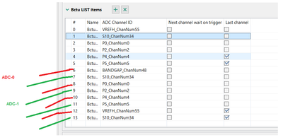

The example uses the TWO PIT0 trigger to trigger BCTU conversion list to perform parallel conversions on ADC0/ADC1.
Each Trigger has one LIST associated with it in the BCTU.
Conversion result for EACH list is stored in individual FIFO of the BCTU.
DMA will transfer the ADC conversion result.

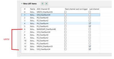

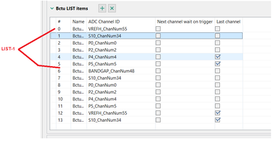

LIST-1 ADC channels
are selected to be converted on each ADC:
LIST-2 ADC channels are selected to be converted on each ADC:--

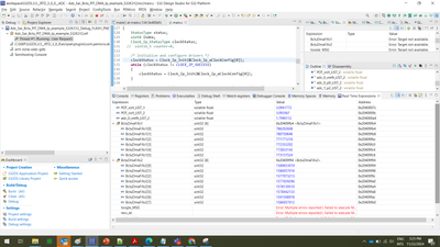

 Converted results from BCTU FIFO are moved by DMA into result array.
 ADC channel S10 is connected to board's potentiometer.
Result :--
