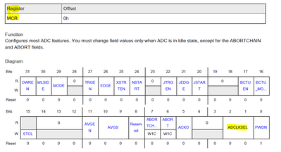

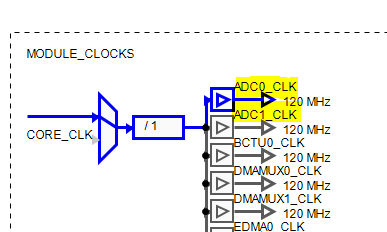

ADC Module clock is ideally the CORE clock :--

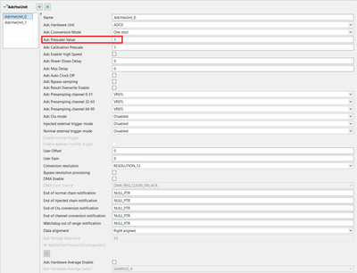

Prescaler In S32DS  is this MCR[ADCLKSEL]) :--

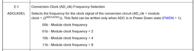

See below snippet from specs for calculation of ADC conversion clock  :--
  • ADC is controlled by one clock signal, the module clock.
  • Internally, the conversion circuit is controlled by the conversion clock, which is derived from the module clock.
  • You must configure the ADC conversion clock divider (MCR[ADCLKSEL]) so that the frequency of the conversion clock is within allowed limits.

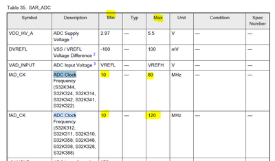

S32K3 Datasheet, ADC MAX MIN clock limit :--
