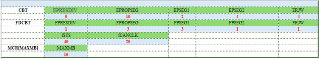

This document provides a brief explanation of the Excel-based calculator developed to assist with the computation of TX Arbitration Start Delay as described in the S32K3 reference manual.
The tool implements the formula provided in the datasheet, allowing users to input relevant parameters and automatically calculate the delay values. It is intended to support engineers in evaluating CAN transmission timing and optimizing arbitration performance in S32K3-based applications.
1.Fill in the clock and CBT and FDCBT configuration parameters according to your requirements.
For example, we fill the parameters according Case 3:
 Then we can get the TASD value for non-FD frames is 24.05.
