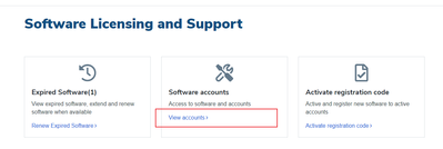

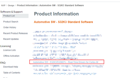

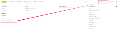

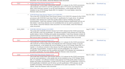

Hello, where is the download connection for S32K3 RTD RTM2.0? The S32K3 RTD 4.4 I installed cannot open the project
Hi @zyc0211 ,
Please sign-in your NXP website account, and see below place:
Shuailin_0-1701068284626.pngShuailin_0-1701068284626.pngShuailin_1-1701068308597.pngShuailin_1-1701068308597.png
Shuailin_2-1701068382263.pngShuailin_2-1701068382263.pngShuailin_3-1701068447957.pngShuailin_3-1701068447957.pngShuailin_4-1701068501893.pngShuailin_4-1701068501893.png
FYI.
If you still can not obtain the RTD 2.0.0 driver, please contact corresponding NXP FAE/DFAE to get the resources.
Shuailin
