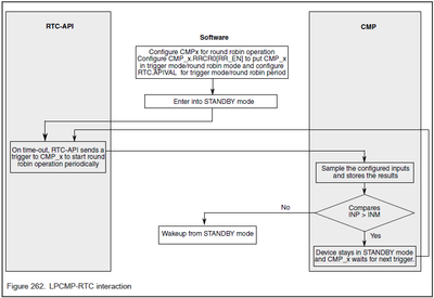

This example routine configures the WKPU & LPCMP units for wake-up. The S32K3XX's LPCMP can operate in trigger mode in both standby and run mode to continuously scan the input channels. RTC-API and LPCMP must be configured before entering into standby mode as per below shown figure:
See chapters 61.1.5 Comparator Trigger Mode & 61.1.6 Interaction with RTC API to cause wakeup from the S32K3XXRM (Rev. 12) for further information.
The register configurations before entering Standby mode for LPCMP trigger mode operation is the following:
  1. Configure RTC.APIVAL to set the period of the round robin operation.
  2. Execute standby mode entry.
The routine waits for SW5 to be pressed, then turns off the green LED, and enters Wkpu_EnterStandby() function which:
  1. Switches CORE_CLK to FIRC.
  2. Initializes the WKPU instance.
  3. Configures WKPU2 & WKPU42 (PTB19).
  4. Initializes and enables interrupt for LPCMP.
  5. Initializes RTC and sets the timer value (in RTCC - APIVAL) to 100ms.
  6. Starts timer.
  7. Enters standby (or fast standby).
While in standby, PTA0/1/2 are active; if a voltage higher than 2.5V is detected (ICU LPCMP DAC Voltage Level = 127), or SW6 is pressed MCU will wake-up.
After wake-up, MCU resets and polls for SW5 to be pressed again.
The RTC timer value can be changed with RTC_PERIOD_DELAY_MS(x) macro defined in Wkpu.h.
