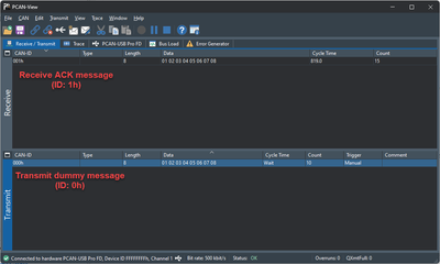

This example project will show user how to use and configure the basic functionalities of WKPU + FlexCAN.
* Test HW: S32K3X4EVB-T172 (SCH-53148 REV B2)
* MCU: S32K344
* IDE: S32DS3.5 & S32DS3.6
* SDK release: RTD 6.0.0
* Debugger: PE Micro
* Target: internal_FLASH
This example routine configures the FlexCAN0 instance for reception. Since RevB2 of the EVB was used for development, CAN TRXCVR used is TJA1443. TJA1443 is initialized in main code (CAN0_STB = 1 & CAN0_EN = 1).
FlexCAN bitrate:
  • Bitrate: 500 Kbps
  • Sampling point: 81.25%
Individual mask is set to 0x0, meaning all IDs are accepted.
Main routine:
  1. Waits for SW5 to be pressed, or for FlexCAN interrupt.
  2. If SW5 is pressed, turns off green LED, disables FlexCAN and switches CORE_CLK to FIRC. It then configures both PTB19 (SW6) and PTA6 (CAN0_RX) for interrupt wakeups.
  3. If either SW6 is pressed or a CAN message is received (edge detect on PTA6), MCU wakes up and will wait for SW5 to be pressed again.
FlexCAN is configured for INTERRUPT; If a CAN frame is received, bRxFlag is set to 1 inside the callback, blue LED is toggled, and an ACK frame is sent back. CAN communication can be tested either with another EVB, or with a PCAN analyzer connected to J32.
PCAN-View log for dummy and ACK messages:
