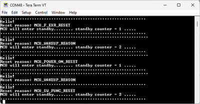

The routine waits for SW5 to be pressed, then turns off the green LED, and enters Wkpu_EnterStandby() function which:
  1. Disables D-Cache.
  2. Initializes RAM ECC (if reset was Power-on Reset).
  3. Adds +1 to the standby counter placed in Standby RAM.
  4. Switches core clock to FIRC.
  5. Initializes the WKPU instance.
  6. Configures WKPU42 (PTB19).
  7. Enters standby.
If SW6 is pressed, MCU will perform a software reset through the Power_Ip_PerformReset() API. After wake-up, MCU resets and polls for SW5 to be pressed again.
In this application, LPUART6 (connected to USB OpenSDA interface) is enabled and will show previous reset reason (external reset, power-on reset, wakeup, functional reset), as well as printing standby counter between resets/standby cycles.
Connect a USB cable to J40, and open a Serial terminal on PC for the serial device with these settings:
  • 9600 baud rate
  • No parity
  • One stop bit
  • No flow control
After either a SW reset, or a wake-up cycle, the standby counter will increase. If a destructive reset or Power-on Reset is asserted, the counter is reset.
