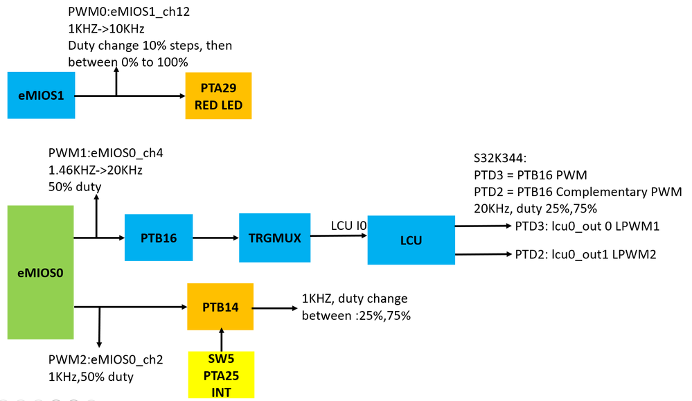

2.2 Software control process
Before talking about the specific MCAL configuration, here is the software flow chart of the functions in this article:
Fig 2
Here you can see that the default situation is the one configured through MCAL, and then the PWM frequency is also modified in the code, and the PWM duty cycle is modified by keystrokes and loop delays.

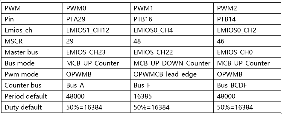

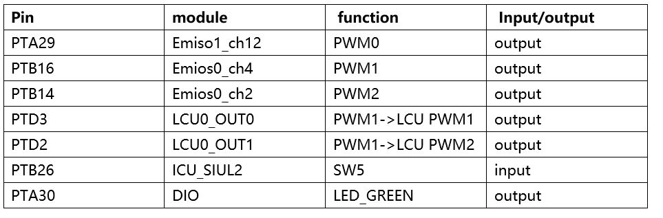

2.3 Resource Allocation Overview
The hardware resources and functions used in this article are listed as follows:
Fig 3

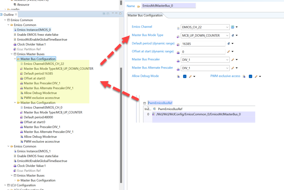

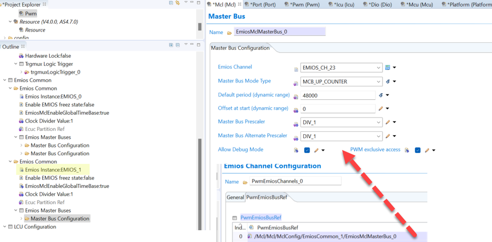

The configuration of emios related buses is as follows:
Fig 4

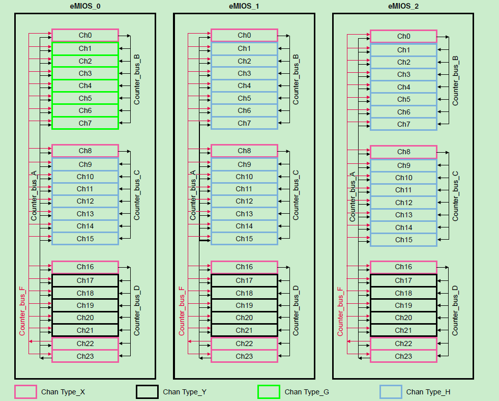

It should be noted here that for the master bus and bus mode in MCL emios, it is necessary to select the appropriate PWM mode and counter bus in the PWM module, otherwise either the configuration will be wrong or the correct PWM waveform cannot be generated.
From the official S32K3 RM, you can check the clock channel and bus type:
Fig 5
For example, if EMIOS_CH23 is selected in PWM0, then this bus corresponds to bus A, and this clock can be used for all channels, so PWM0 is CH12 and can use Bus A. CH22 corresponds to bus F, and this clock can also be used for all channels, so it is no problem to select Bus F for PWM1 CH4. CH0 corresponds to bus B, and this clock corresponds to channels 0-7, so it can also be used for PWM2 is CH2. When selecting the counter bus clock source for your EMIOS channel, you must consider the channel coverage of the counter bus.

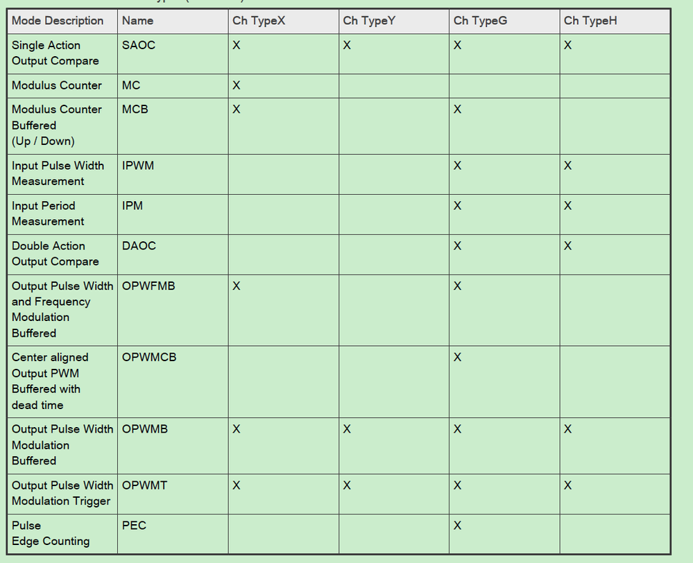

In addition to the selection of the counter bus, there is also the PWM mode selection, which is easier to handle. For clock counting up, select OPWMB, and for clock counting up and down, select OPWMCB center-aligned PWM.
     In actual use, the mode selection is usually determined based on one's own PWM requirements, and then based on the following RM table:
Fig 6
You can find the channel types that the corresponding mode can support, and then select the corresponding channel, counter bus, etc. according to the channel type in Figure 5. With these basic knowledge, we can directly enter the EB configuration.

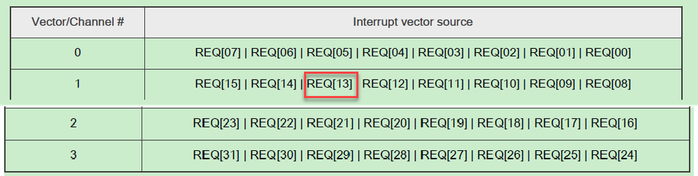

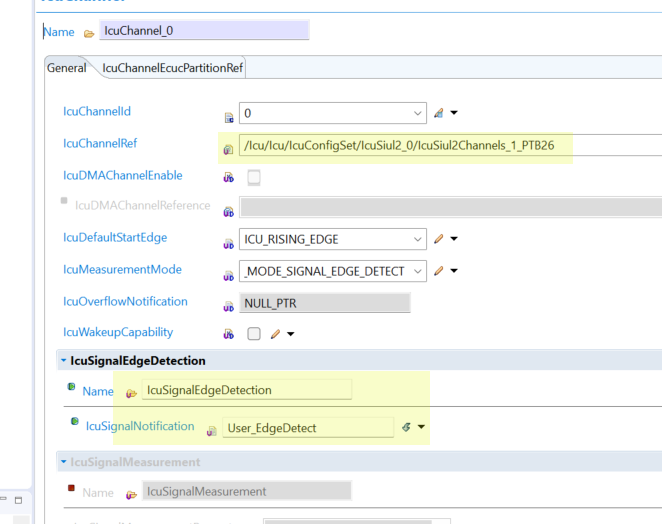

2.4.2 Icu module
First, configure IcuSiul2, the goal is to enable the input interrupt of onboard SW5, PTB26. PTB26 corresponds to EIRQ[13],
Then, the corresponding interrupt situation is as follows:
Fig 8
Fig 9
(1) Icu->IcuSiul2->IcuSiul2Channels:13
(2) Icu->IcuChannel configuration is:
Fig 10
Select IcuChannelRef as the previously configured IcuSiul2Channels, and add the interrupt notification function:
User_EdgeDetect, note that this function is the name of the user interrupt processing function that needs to be added in the code.
   (3)Icu->IcuHwInterruptConfigList-> ICU Peripheral ISR Name: SIUL2_0_IRQ_CH_13,IcuIsrEnable enable

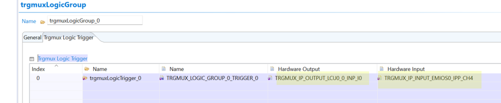

2.4.3 Mcl module
This module is mainly used to configure emios counting clock, trgmux, and LCU configuration.

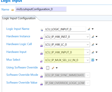

(1)Mcl->Trgmux Logic Instance->Hardware Instance: TRGMUX_IP_HW_INST_0
  (2) Mcl->Trgmux Logic Group:
Fig 11
The main purpose is to connect PWM1 Emios0_ch4 to LCU0_IN0 through Trigmux.

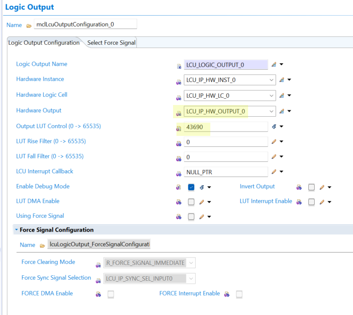

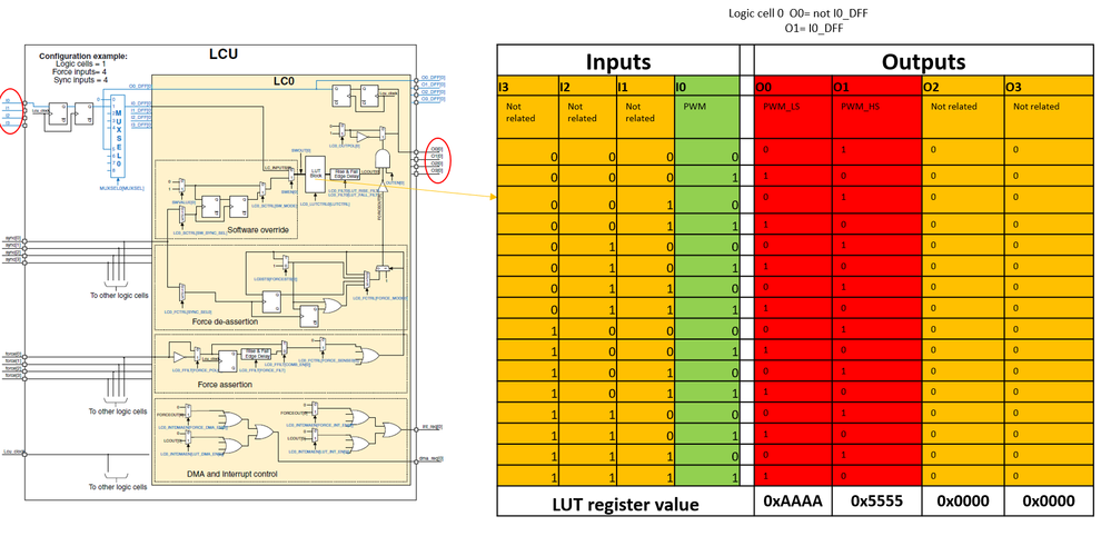

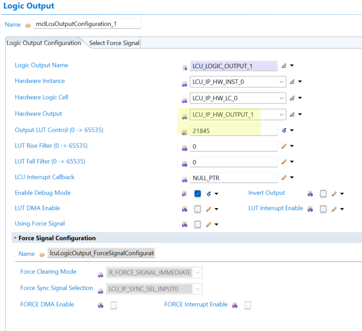

(3)Mcl->LCU Configuration
Here is the configuration of the LCU module. The main function is to configure the logic input and logic output. There is one input IN0 and two outputs OUT0 and OUT1.
Fig 12
Fig 13
Fig 14
OUTPUT0  value is 0XAAAA=43690,
OUTPUT1 value is 0X5555=21845
The purpose of this is to generate a pair of complementary PWMs from the input PWM.
Fig 15

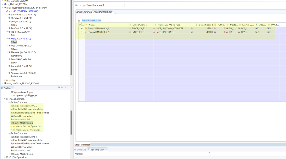

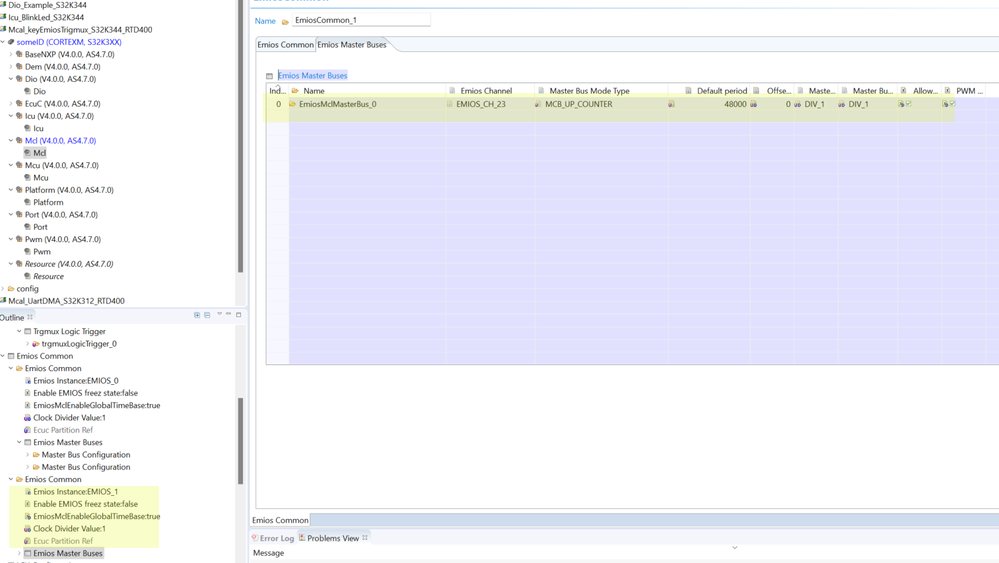

(4)Mcl->Emios Common
Add two Emios, EMIOS_0 and EMIOS_1, which means two EMIOS are used.
EMIOS0 is configured with two master bus channels: CH_22 and CH_0, and has different mode types, counting up and down and counting up.
EMIOS1 is configured with one master bus channel: CH_23, counting up
Corresponding to Figure 4.
Fig 16
Fig 17
Note that the channel here is not the actual PWM output channel, but the counter bus channel of the PWM channel, which has the ability to provide clocks.

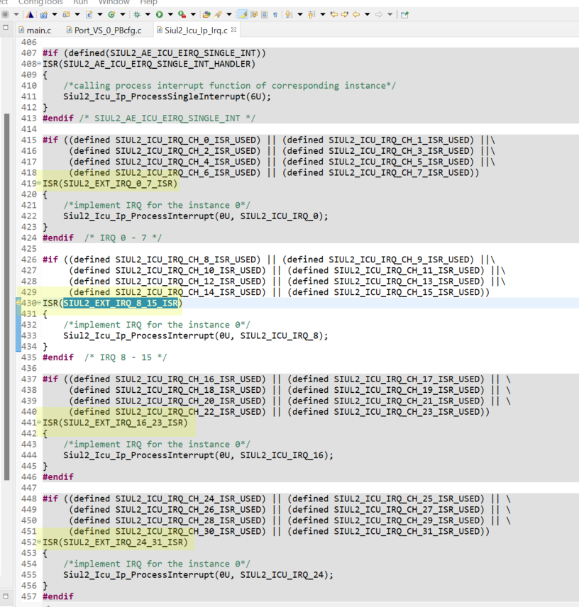

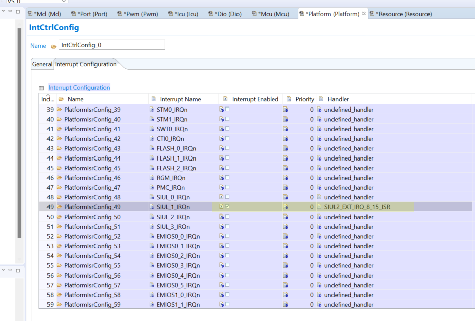

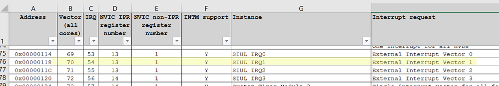

2.4.5 Platform module
Platform->Interrupt Controller->IntCtrlConfig0, enable SIUL_1_IRQn, and add Handler as:
SIUL2_EXT_IRQ_8_15_ISR
Note that this SIUL2_EXT_IRQ_8_15_ISR is not written randomly, but must correspond to the one in Siul2_Icu_Ip_Irq.c, otherwise an error will be reported.
Fig18
Different interrupts have different interrupt service functions. You need to find the function name defined in the code and fill it into EB.
EB configuration is as follows:
Fig 19

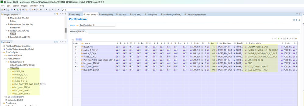

2.4.6 Port module
The configuration of 8 pins is as follows:
Fig 20
As you can see, there are 3 main EMIOS PWMs, one input interrupt, one output GPIO, and two output LCU complementary PWMs.

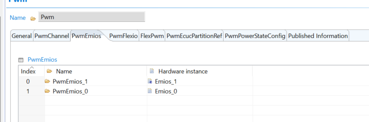

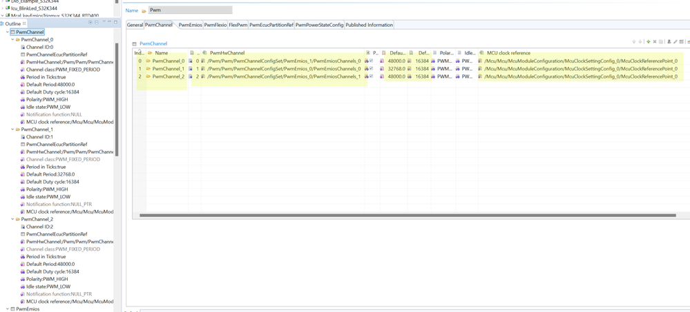

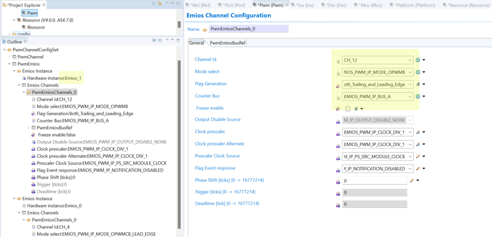

2.4.7 Pwm module
Mcl configures the counter clock channel of EMIOS. The PWM channels to be output need to be configured in the Pwm module and linked to the MCU clock source and the emios counter bus source in Mcl.
(1) Pwm->PwmEmios
Add two groups for the corresponding EMIOS modules. For example, this article uses EMIOS0 and EMIOS1, so two need to be added:
Fig 21
For PwmEmios_1, there is one channel, and the configuration is as follows:
Fig 22
PwmEmiosBusRef: /Mcl/Mcl/MclConfig/EmiosCommon_1/EmiosMclMasterBus_0
Fig 23
As you can see, the busRef of PwmEmios_1 here is Emios_ch_23 in Mcl, that is, BusA.
That is to say, the bus reference clock used by EMIOS1_CH12 comes from EMIOS1_CH23, that is, Bus A.

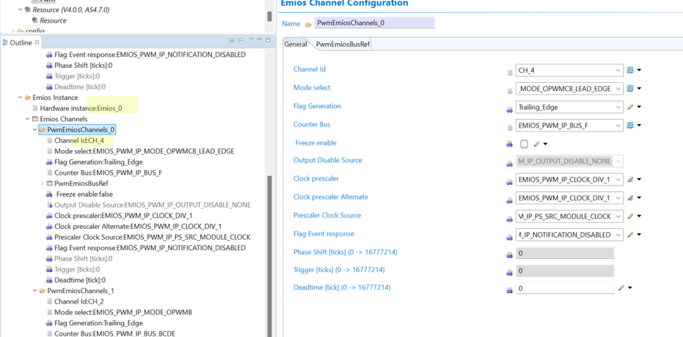

There are two channels configured in PwmEmios_0, and the configuration is as follows:
Fig 24
Fig 25
The bus reference clock used by EMIOS0_CH4 comes from EMIOS0_CH22, which is Bus F.
Another EMIOS0 channel:
Fig 26
Fig 27
The bus reference clock used by EMIOS0_CH2 comes from EMIOS0_CH0, that is, Bus B, so select Bus BCDE.
At this point, we can clearly understand the relationship between the real PWM output channel and the internal MCL Emios counter bus channel.

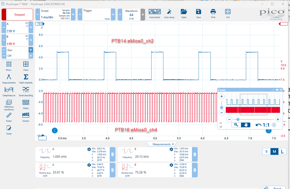

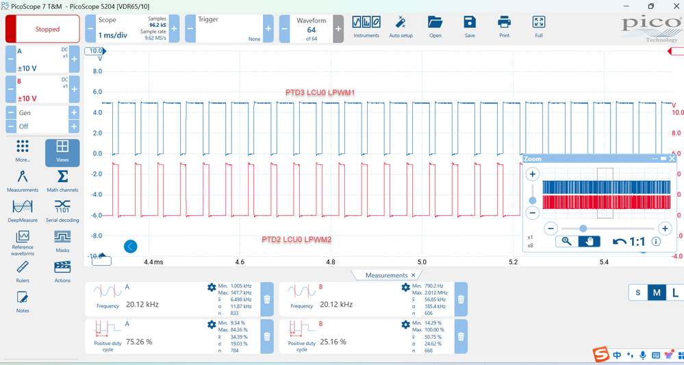

3. Test Result
After power-on, the onboard red light flashes, then gradually turns bright from off, and flashes alternately with the green light.
Test PWM1 PTB16: EMIOS0_CH4, the waveform is 20Khz after stabilization, and the duty cycle changes alternately between 25% and 75%. PWM2 PTB14: EMIOS0_CH2, after stabilization, the frequency is 1KHZ, and as the onboard SW5 is pressed, the duty cycle changes alternately between 25% and 75%.
Test PTD3, PTD2, it can be seen that it is a pair of complementary waveforms, and the frequency is the same as PTB16, and the duty cycle change rule is also the same. It can be seen that the key interrupt, 3 main PWM, and 2 LCU PWM in this article are already working.
Fig 29
Fig 30
