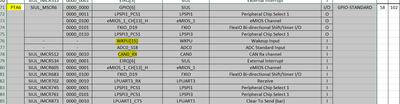

Wake-up source, CAN-0-RX :--
According to the IOMUX table in RM, for example, PTA6 can be used as WKPU15 and CAN0_RX. It means that the WKPU15 input doesn't require specific MSCR configuration.
So if its input buffer is enabled and the corresponding WKPU input channel is enabled/configured in the WKPU, it should be able to act as wake-up input.

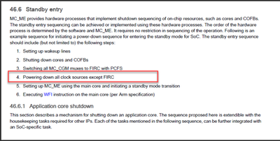

Standby entry :--

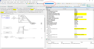

STandby clock :--

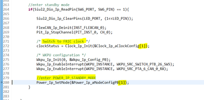

Enter Standby mode :--
