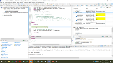

 The purpose of this demo application is to present a usage of the
EMIOS IP Driver for the S32K3xx MCU.
This example uses the custom IRQ.
 The example uses:--
EMIOS-1 - ch-0  --> PTC24 --> Generate the PWM
EMIOS-1 - ch-1  --> PTC25 --> is the ICU channel to measure the duty
Result :--
* Test HW: S32K3X2EVB-Q172
* MCU: S32K312
* Compiler: S32DS3.5
* SDK release: RTD 3.0.0
* Debugger: PE micro
* Target: internal_FLASH
