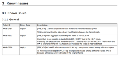

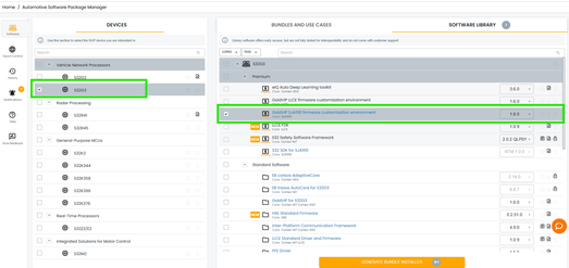

Checking the release notes I can see there are several several issues with VLAN tagged ethernet packets [page 3 and 4, S32G PFE Firmware 1.10.0 Release Notes, Rev. 1.0.0 — 7 November 2024]:
Although they may not be directly related to the flow you are traying to use, what I would recommend is using an older version of PFE, in this case, for BSP43 the officially supported version of the PFE firmware is 1.8.0 [page 2, Linux BSP 43.0 Release Notes for S32G3]:
Can you try with this FW version and let me know if the problem persist?
Thanks in advance.

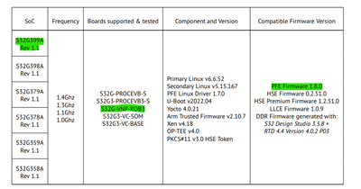

rares_o

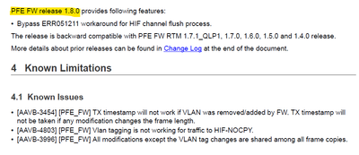

I just double checked the compatibility of the BSP 43.0 with the PFE FW. Maybe you have an older version of the BSP 43.0 release notes but in the latest one,  the PFE Firmware 1.10.0 is required:
 Also the same "known issues" are present in the PFE Firmware 1.8.0 Release Notes as well:
 I don't think this will solve the issue if this is the case. Do you still think it's worth flashing the older PFE FW?

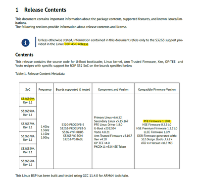

alejandro_e
Hello @rares_o,
Thanks for the observation, there seems to be an update of the BSP43 release notes, just to confirm, which date is shown in the fist page of the file you have downloaded? In my local file I can see "11-Dec-2024" and in the online file I see "12-Dec-2024" (in which I see the same version you mentioned), considering this and the fact that you also pointed out that the same problems are present in version 1.8.0 I no longer recommend testing with an older version. Please allow me some more time to investigate possible know issues and I will come back to you once I have relevant information.
Can you share the revision of the PFE FCI API reference manual you as using to get the example?

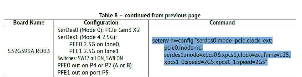

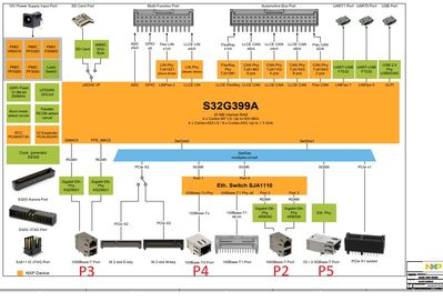

Ok so i made the VLAN bridge work, but not really as indented. Here is what I did:
1. Configured the SerDes as follows:
setenv hwconfig "serdes0:mode=pcie,clock=ext;pcie0:mode=rc;serdes1:mode=xpcs0&xpcs1,clock=ext,fmhz=125;xpcs1_0:speed=2G5;xpcs1_1:speed=2G5"
Based on the S32G3_LinuxBSP_43.0_User_Manual.pdf  this configures the PFE0 on P4/P2 and PFE1 on P5:
2. Connected each PC to the following ports of the S32G3 board: P4 and P5
3. Configured the PFE with the configuration you send.
Now i am expecting the PFE0 and PFE1 VLAN bridge to be functional but it is still not working.
* If i configure the bridge to support non tagged messages between PFE0 and PFE1 it will work just fine.
But the good news are that the VLAN bridge between PFE1 and PFE2 (P3B) works fine.
This lead me to believe that the PFE0 is not correctly configured. I looked over the boot logs and indeed there are some warnings regarding PFE0. I attached below the logs of interest for PFE 0, 1 and 2:

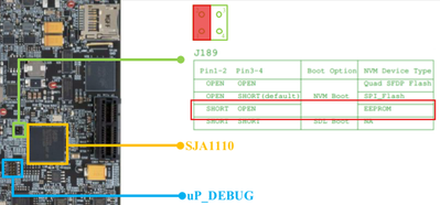

I was able to use P4 and P5, I had to change the jumper configuration of the SJA1110 (J189) to the following:
SW17: All ON
SW8: ON
Just as reference, this is the routing of the ports in the RDB3:
I focused on the network functionality, I did not configure the VLAN tags.

Therefore in my setup (using the same hwconfig as you) the only blocker for P4 was the jumer/switch config:
Let me know if with this configuration you can solve your problem.

My colleague suggested to try using Vlan 101.
Another method could be to configure the SJA1110 Firmware to allow Vlan tagged messages to go through, you can get the firmware customization environment from the GoldVIP SW package, in the AUTO-SW-PACKAGE-MANAGER:
If you don't have access to this package, please contact your FAE/NXP representative so he/she may be able to help you. 
Once you get the SJA1110 Customization environment you can create a post in the Other-NXP-Products/ community so one of my colleagues with expertise in the topic may help you configuring the SJA1110 for VLAN messages.
Please let me know if you have any other question about this topic.
