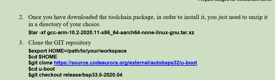

When I git clone from https://source.codeaurora.org/external/autobsps32/u-boot/ flollow AN13750,the error happened like thus:

Hi @yqlau,
Thanks for reaching out to NXP.
The source code of the Yocto project and its components has been moved from Codeaurora to GitHub.
You can check out the specific branch from GitHub.
link of the repo: https://github.com/nxp-auto-linux
Also, please find the migration guide which helps you.
https://github.com/nxp-auto-linux/linux-bsp-utils/tree/master/codeaurora_migration
