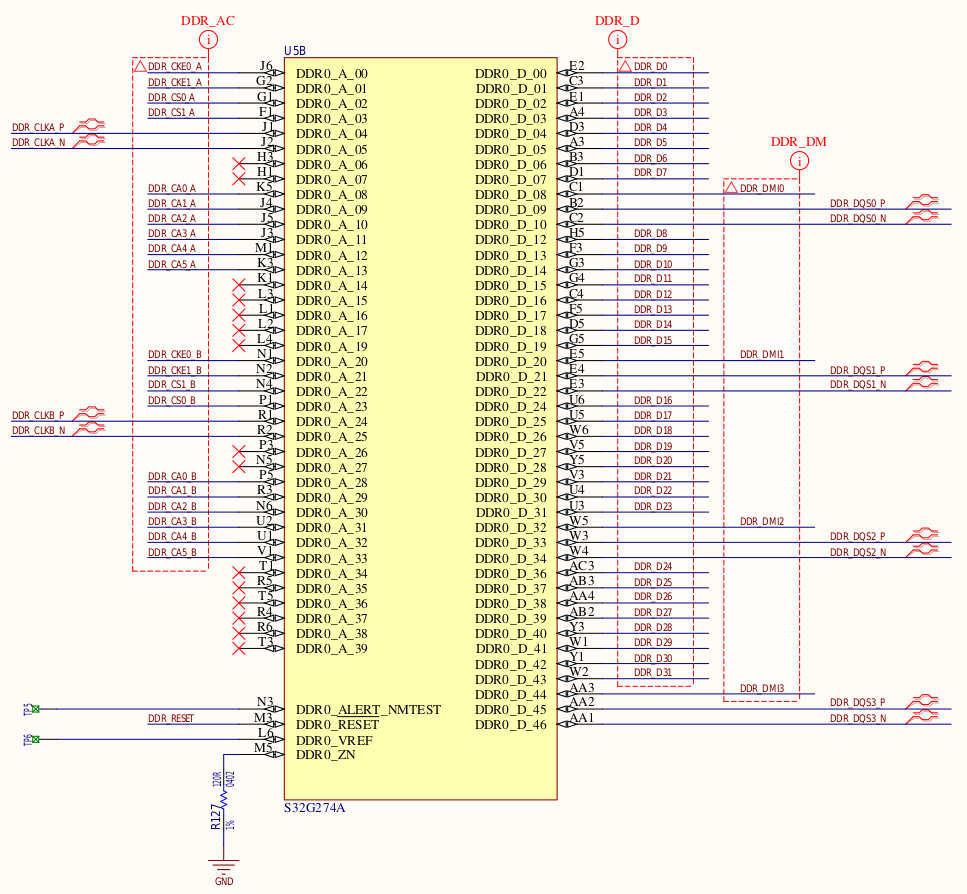

Please help share the following information:
1.Schematic diagram (including S32G DRAM port and LPDDR4 schematic diagram)

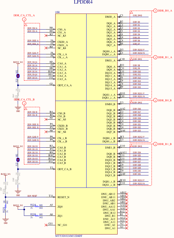

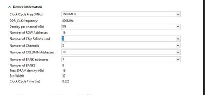

1-) Schematic diagram of DDR Port and LPDDR4 is as follows:
DDR connection1DDR connection1DDR connection2DDR connection2DDR connection3DDR connection3
2)LPDDR4 part number is MT53D512M32D2, which is same chip but 2GB version used in S32G274-RDB2 board (this board has 4GB RAM whose part number is MT53D1024M32D4)
3)DDR view screen shot is:
DDR device infoDDR device info

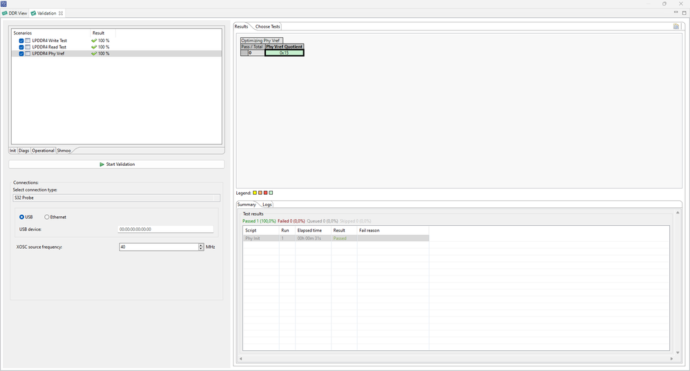

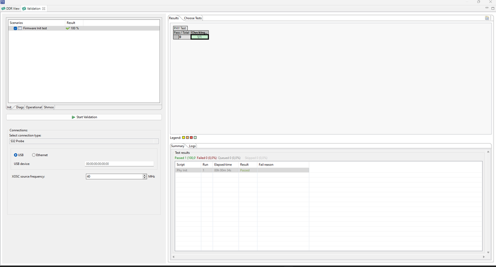

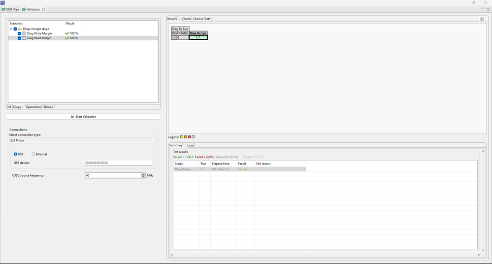

4) "init", "diags", "operational" and "shmoo" test results screen shots are:
DDR_Diags_test_resultDDR_Diags_test_resultDDR_init_test_resultDDR_init_test_resultDDR_operational_test_resultDDR_operational_test_resultDDR_shmoo_testDDR_shmoo_test
i changed density per channel parameter to 2GB and by that way all test are passed as you can see in above screen shots,
all information that you want are given, please let me know if you need any additional information,
Thanks in advance,
Best,

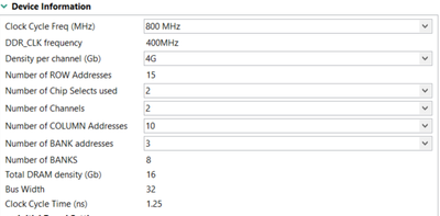

MayanksPatel
Hi @0xEC,
It seems that there is a problem with your configuration, please try the following configuration and share the test results here.

0xEC
as i mentioned in previous reply, i changed just number of chip select parameter that you suggest to apply,
it generates init code and i adapted it to TF-A source code and it still could not initialize DDR ram.

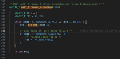

i got more detail about the flow, the TF-A returns error code in ddr_init.c source code in execute_training(const struct ddrss_config* config) function which calls wait_firmware_execution()
and in this function there is an register read
*mail = mmio_read_32(DDR_PHYA_APBONLY_UCTWRITEONLYSHADOW);
which returns 0xFF and in source code comment it says 0x07 is success 0xFF is failure

25,487件の閲覧回数

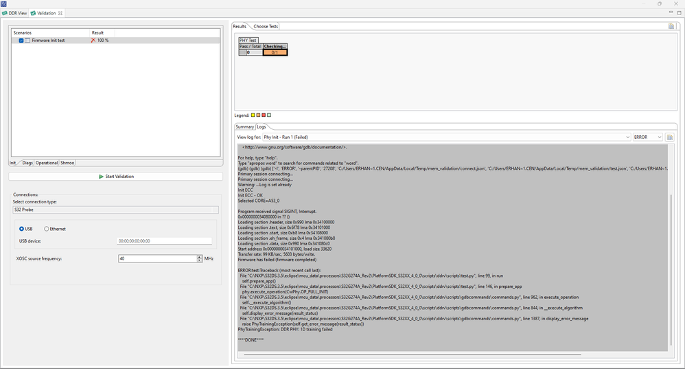

0xEC
Hi @MayanksPatel,
After changing parameter that you describe, it fails even in init test, if i changed Number of Chip Selects used to 1, test passes. the result of configuration suggested by you is as follows:
best,
