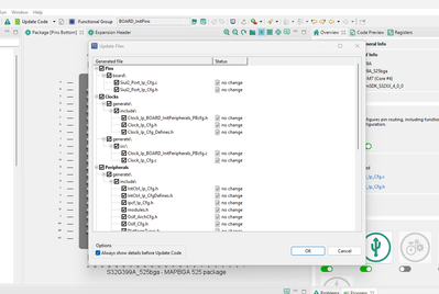

hi everyone,
I want to run sample IPC project from S32DS, i installed ipc extension but while compiling the project i got error which says ipc-shm.h file not found as follows:
I created project from example project and entered *.mex file which direct a new tab and in this tab i generated files by clicking following button:
I do not know whether ipc-shm.h must be generated or created manually? in documents there is no such comment.
Could someone help me on this topic?

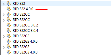

0xEC
after uninstalling RTD_4.0.1 and installing RTD_4.0.0, i got following error
5,756 次查看

0xEC
what do you mean by saying installation details?
I removed RTD v4.0.1 and install RTD 4.0.0 and create fresh ipcf example project and it gives same error. Then i also deleted the ipcf package which was installed while using RTD v4.0.1 and re-install IPCF package but i still got same error.

0xEC
installation details:
My ipcf project SDK tab is empty:
what is the problem in here?
