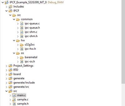

We are seeing that the IPCF files are provided under the example:
We have the following packages:
Please, let us know.

when i click update code in configuration tab, RTD folder is generated and static codes for it is placed under it, also auto generated codes are generated and placed but there is no IPCF created folder as you shared in reply.

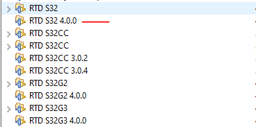

It might be related to the missing package we mentioned previously:
5,766件の閲覧回数
Daniel-Aguirre
Also, we seem to understand that a package is missing:
Could be that it was not selected to be installed.
