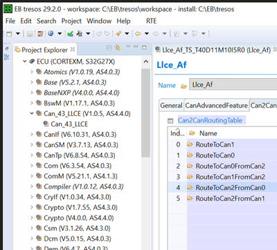

fenghua_jiang
I also have a question about Can-to-eth .
I set Can2EthRouting Table as attached picture,but I can not receive any packets from pfe2.

Daniel-Aguirre
There is a known issue on the ETH2CAN example provided on LLCE v1.0.4. You can see the following thread for the fix:
Solved: S32G2 LLCE-1.0.4 can2eth - NXP Community
Also, there was an update on AN13423 (link: AN13423: Using CAN2CAN, CAN2ETH and ETH2CAN Features of LLCE on S32G Application Note (nxp.com)) where the different configurations to both CAN2CAN and CAN2ETH examples are explained.
Please, let us know.

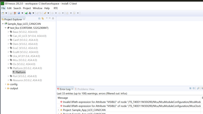

viswa_kondapall
Hi Danel,
An13423 document has naming convention difference is the project creating. We followed An13423 document and version or target mismatch error we got in EB tresos and S32 design studio.
CAN2CAN example application MCU name is "S32G2XXM7" but EBtresos and S32 Design studio -error : version mitch or target mismatch :
Goldvip binaries workspace projects  MCU name as given as "S32G27X" which is working fine with out errors.
regards,
Viswanath

Daniel-Aguirre
The project you have imported to EB Tresos needs the specific plugins to work with. We are seeing that you may not have these plugins installed.
As for the needed drivers to work with the CAN2CAN project, you need the following:
  • RTD v3.0.2 HF01
  • LLCE v1.0.4
If you already have them installed, you need to copy the plugins into the EB/tresos/plugins directory and reload EB Tresos and import the project again (due to possibly EB tresos deleting some modules). The plugins should be available under the following addresses (or similar):
  • RTD: "C:\nxp\S32DS.3.4\S32DS\software\PlatformSDK_S32XX_2022_03\SW32_RTD_4_4_3_0_2_D2203"
  • LLCE: "C:\nxp\S32G_LLCE_1_0_4\plugins\eclipse\plugins"
This should help with the non-available modules.
Also, this same CAN2CAN example is provided on S32 Design Studio, which may help depending on your current workflow. Still, this needs the above-mentioned drivers to work with it.
There is also the starter guide that provides insight on the setting steps needed to work with the LLCE Firmware. This should be available under the following address (or similar):
"C:/nxp/S32G_LLCE_1_0_4/firmware/llce_interface/doc/LLCE_getting_started_guide.pdf"
