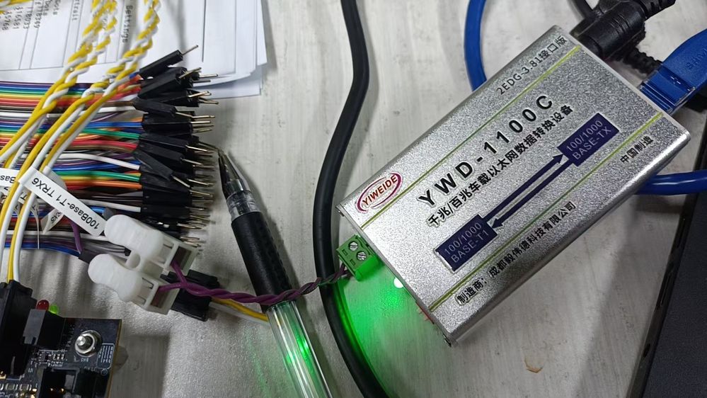

1.Do you test the BSP42 package that have not modified?
2.How do you change the 100Base-T1 port to eth port signals for the ping testing, which device are you using?
Joey

liujialu_2024
my T1-to-RJ45 device:

liujialu_2024
with bsp 42.0 default image, it report error also.
v6.6.32 kernel does not support IPCF, so, we need v5.15.158 kernel.
according to the S32G2_LinuxBSP_42.0_User_Manual.pdf
chapter: 7.7.3 Enabling SJA1110 DSA driver, to enable DSA of SJA1110, then
$ ifconfig trx6 down
$ ifconfig trx6 192.168.2.123 up
my PC's ip address is 192.168.2.211, so ping can work now.
