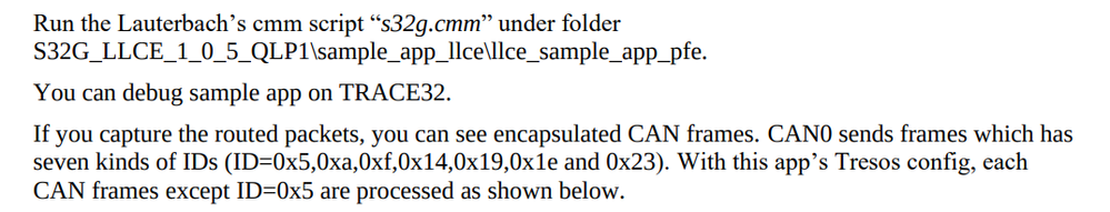

Hi NXP team,
We are currently studying S32G3 ETH2CAN. According to “AN13423: Using CAN2CAN, CAN2ETH and ETH2CAN Features of LLCE on S32G Application Note”, after building int_app.elf, we need to use TRACE32 to debug the sample application.
Our questions are:
  1. If we do not have a TRACE32 debugger, can ETH2CAN still run?
  2. If yes, how should it be implemented?
Jacky

hi,Jacky
Thank you for contacting us.
>>>Yes, but the debugger is the good way to debug the code.
>>>You can try to create the Blob file of int_app.elf, and flash the Blob file to SD-card of Nor-Flash. Then, set the S32G to boot from SD of QSPI.
You can refer to this document for the boot from SD card.
https://community.nxp.com/pwmxy87654/attachments/pwmxy87654/S32G/7641/1/S32G-VNP-RDB2-SW-UG.pdf
