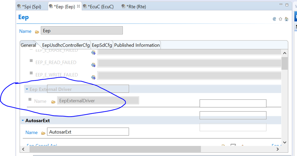

Hello ,
i am using Gold Vip 1.11.0 package , for my custom build S32g399A board . where i am using ST M95M01-DWMN3
So i have integrated the EEPROM driver in the package but i am not able to enable the external driver reference container which is highlighted below, kindly let me know how to enable this container ,or any dependency related to this .
Thanks and Regards
Sandeep

Daniel-Aguirre
To access external EEPROM through SPI, we can recommend using the SPI driver available under the RTD, since it provides the basic SPI communication with S32G.
Please, let us know.

Daniel-Aguirre
We might be misunderstanding the overall inquiry. If so, we do apologize.
The Eep driver itself is used mainly for the uSDHC/eMMC communication under S32G, as told under the Eep Driver User Manual:
For which, we understand that it might not be enabled to interface with an external EEPROM under S32G, but for an SD or eMMC. More information can be found under the User Manual and Integration Manual available under the Eep plugin itself.
