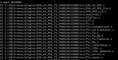

Hi. Sorry for posting questions so often.
I'm posting a question because I'm getting an error while trying to build the example files from PFE into a make file.
This is the version of the file I'm using. Version compatibility seems to be fine.
PFE-FW_S32G_1.7.1
PFE-DRV_S32G_M7_MCAL_1.3.0
SW32G_RTD_4.4_4.0.2
Tresos 27.1.0
$ make build HW=RDB3

To summarise, I am getting an error related to RTABLE_IPV4_SRC_IP_ADDR in this c file.
src/sample_app_ethswt_eth.c:214:26: error: 'RTABLE_IPV4_SRC_IP_ADDR' undeclared (first use in this function)

Are you compiling the examples available under PFE?
From our side, we seem to be unable to reproduce the outcome you are seeing with the available examples:
Have you generated the configuration prior to compiling the example?
Please, let us know.
