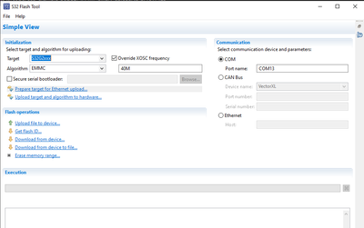

1,591件の閲覧回数
Daniel-Aguirre
Are you using any NXP reference boards? Which RTD version are you using?
We might not be able to understand the overall implementation you are trying to do, but for the following comment:
"I am trying to upload a binary file created with IVT that works on SD card to eMMC memory."
We understand that you want to flash the eMMC available under your board, is this correct? If so, we understand that S32 Flash Tool already provides the required algorithm for this:
Please, let us know.
1,588件の閲覧回数
won0020
thanks for your reply. I am using S32G-VNP-GLDBOX 47800 rev D1. I already solved the problem.
I forgot to switch SW4.6 to ON.
Best Regards
