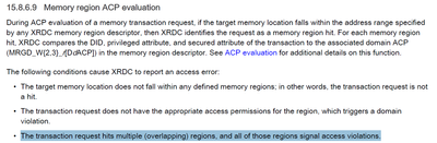

If there is address overlap between multiple memory regions of an MRC, what happens to MRC when an address falls on multiple memory regioins?
Thanks a lot!

The following is told under the S32G2 Reference Manual [Page 602, S32G2 Reference Manual, Rev. 7, February 2023]:
Don't know if this information helps.
Please, let us know.

It's very helpful. Thanks a lot.
