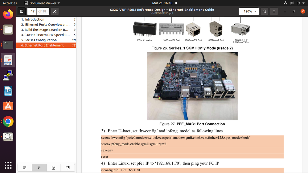

We followed S32G linux 33.4 user manual for TFTP server setup in Ubuntu 20.4.
Installed all libraries and configured Host Ip address :192.168.110.10
Installed all libraries as per the document. Target board set IPAddr(192.168.110.10) and server IP (192.168.110.20).
after ping from target device : this error came. Unable to ping.
ARP Retry count exceeded; starting again
ping failed; host 192.168.110.20 is not alive
PFE_MAC-1 Ethernet cable i connected for tftp:
How to fix the ping issue , is it issue in target or in the host configuration.

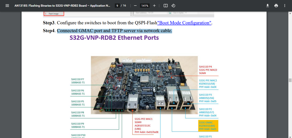

Hi Chandan
Hope you are doing well
Connected GMAC port and TFTP server via network cable.
Please also referee Document Number: AN13185   page no 9 and 10  along with S32G-VNP-RDB2 Ethernet Enablement Guide. Hope this will help you.
