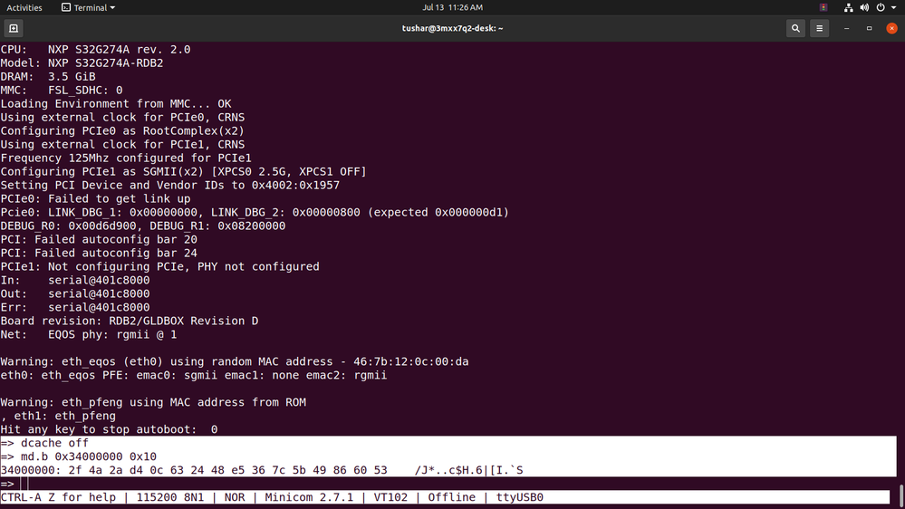

I am debugging S32G3 IPCF and
I found that in the u-boot terminal, I cannot use md 0x34000000 to obtain the content of sram
(note:S32G2 is ok)
Screenshot from 2023-07-12 14-42-19.pngScreenshot from 2023-07-12 14-42-19.png

Hi Ni Yu
Hope you are doing well
There my be problem with cache, try below command in u-boot
=> dcache off
=> md.b 0x34000000 0x10
the result with my board as below
Screenshot from 2023-07-13 11-26-56.pngScreenshot from 2023-07-13 11-26-56.png
