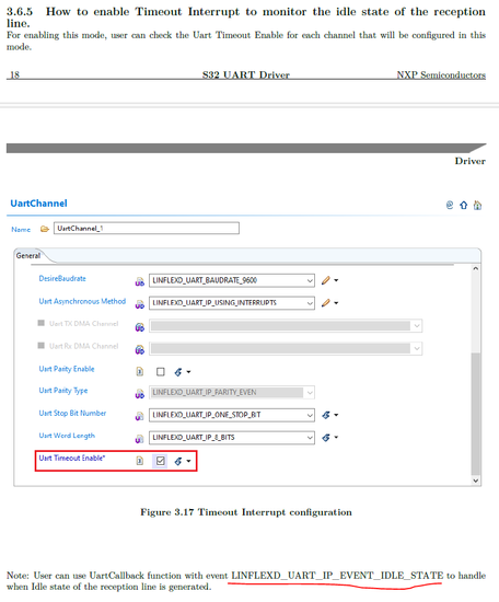

  As shown in the figure above, we see the Uart module timeout related functionality in the Uart module UM. So we Enable the function of "Uart Timeout Enable", generate the configuration file, compile and run in the project.
  Within the project, we enable the "Uart Callback Capability" option, using a custom Callback function, where the Callback parameter Event is the enumerated type defined by the Uart module:
KeithWANG_1-1712480161716.png、
  At the same time, the data on the Uart channel is sent at a frequency of 1Hz. Through Lauderbach debugging, we find that after the program starts running, the program triggers an interrupt of the event LINFLEXD_UART_IP_EVENT_IDLE_STATE and enters the Callback function. Uart then stops updating the data and looks at the register as follows:
  Then, we do the corresponding processing under the event, found that when the event is triggered, re-call "Uart_AsyncReceive" function, so that the Timeout event is rolling triggered;
  Can we understand the timeout mechanism of uart as follows:
  When the Uart channel receives a frame of data, if the Uart is idle, the register UARTCTO will increase one by one. When the UARTCTO is equal to the preset register UARTPTO, the timeout event will be interrupted and RxEn register will be disabled, and the Uart will not actively resume the receiving state. If the Uart_AsyncReceive function is called again after the received data is processed, and the Uart is still idle, it will enter the timeout interrupt again.
  We don't know if the chip's Uart mechanism is as we guessed. If not, please correct, so that we can better achieve business function.
  We hope that the timeout mechanism of the Uart is as follows: The timeout interrupt only notifies the Uart when it changes from busy to idle. And you don't need to call the Uart_AsyncReceive  function again. In this case, the relevant interrupt is triggered. In this way, we can process the current frame data received when the interrupt is triggered, providing real-time data transmission.
Hope NXP can have an expert answer, thank you!

Thanks for your feedback. We still have some doubts on regards of the application, since UART can only be synchronized if both interfaces are set at the same baudrate, and at this moment we understand that they are not. Again, this seems to be a misunderstanding from our side, we do apologize.
As for the overall situation, what you are mentioning under point 5 seems to be correct. If you are expecting to receive information, but you cannot wait for it, AsyncReceive is a non-blocking function which should trigger an interrupt once information is available under the respective buffers. Also, the following recommendations are shown under the S32G2 RM:
For which, if the number of bytes to be received are not always the same, the recommendation is to receive byte per byte, to trigger the respective interrupt as expected.
Please, let us know.

Thank you for your attention, the following questions to clarify and confirm:
1. The version of the RTD is S32_RTD_4.4_4.0.1_D2302, and the version of the Uart module is V4.0.1, AS4.4.0.
2. The development board we use is S32G-VNP-RDB2, namely GoldVIP. Our self-developed T-Box design and development based on reference
3. The example we use is the Autosar version provided by EB, AutoCore_OS, which is modified based on this project
4. The baud rate of the UART channel is set to 460800 BPS, but the GNSS module connected to the channel sends 1bps of data. In addition, the timeout module that we enable is under the LINFlexD module, and the UART mode (UARTCR[UART] = 1) is selected.
5. “The timeout feature will trigger an interrupt, and you are looking for receiving frames in the timeout interrupt?” Basically yes, it is also based on GNSS data frames of indefinite length. We hope to receive an interrupt at the end of receiving, and then the channel will continue to receive. The interrupt can only give a Notification, just like the notification in ADC module. Of course, recently we looked at the relevant manual introduction, it seems that the use of Uart at this stage is the need to constantly call Uart_AsyncReceive related functions to enable the receive register to open the channel, so that the data is constantly rolling reception.
  Thanks! Looking forward to your reply
