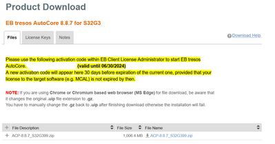

How to open the Bootloader project?Do I need to pay for EB lisence? I have installed GoldVIP EB Temporary lisence ,and I can compile the APP project。
Version:GoldVIP1.11.0
project:realtime\s32g399ardb3\bootloader\workspace\Bootloader_S32G3XX_ASR_4.4_M7(failed)
project:realtime\s32g399ardb3\can-gw\workspace\goldvip-gateway(Ok)

Hello, @AntZeng
Thanks for the update.
According to the GoldVIP UM, the Elektrobit ACP for S32G3 8.8.7 is required, I suggest installing it for a trial, to check if there are still license issues. The tool could be downloaded from your account list, like the following:

chenyin_h
Hello, @AntZeng
Thanks for the feedback.
Would you please help to provide the version of EB? A snapshot after clicking help->EB tresos details is preferred.
For the 3 modules listed in your first picture, they are part of the Safety packages, which is the premium software, for which we recommend contacting your local NXP FAE/DFAE/representative for more information on this regard.

AntZeng
the version of EB,28.2.

chenyin_h
Hello, @AntZeng
Thanks for the question
May I know what is the actually error you met during the building for Bootloader_S32G3XX_ASR_4.4_M7 project? Any logs/snapshots related with the errors?

AntZeng
1.Three modules are not installed。and I can't find  these modules。
2.remove Not installed modules,  generate project ,Error :"all modoules  no lisence"。
3、but I can open APP project(\GoldVIP-S32G3-1.11.0\realtime\s32g399ardb3\can-gw\workspace\goldvip-gateway)。lisence file。(GoldVIP Temporary lisence,3 months)
