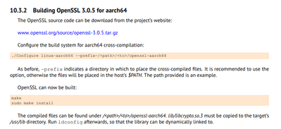

Hi Community,
(Yocto BSP 40.0, NXP s32g399ardb3) S32G3
I am currently working on TLS offloading i.e instead of TLS I want to use HSE Keys in my applications.
Is there any way to offload TLS and use HSE algorithms??
1,737件の閲覧回数
alejandro_e
Hello @pramod22b,
We do offer support to run SSL/TSL operation in the HSE, please check section 10.3.2 Building OpenSSL 3.0.5 for aarch64 of the BSP40 user manual [page 79, Linux BSP 40.0 User Manual for S32G3 platforms] which is under setion  10 HSE Security Support:
if possible, please review section 10 completely, as it explains all the necessary prerequisites to use the HSE API in Linux.  
Let me know if this information solved your question.
