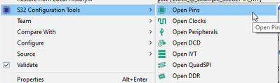

I used the SW32G_RTD_4.4_4.0.2 and added it in Design Studio. After compiling the application I got this error:
fatal error: StandardTypes.h: No such file or directory
So, could you please help me to find the solution?
Note: this header file will call by Siul2_Dio_Ip.h

Thanks for your feedback. For the following comment:
No, for the examples how can I do the setting tools?
We understand that you did not generate the required code under the example. For that, you right-click under the project itself then select the following option:
Then, under configuration tools, click the following button:
It should be green prior to the generation of code and gray (as shown above) once the code has been correctly generated. From our side, we have generated the example you have provided the logs for no problem:
Please, let us know.
This the error that I paste here:
