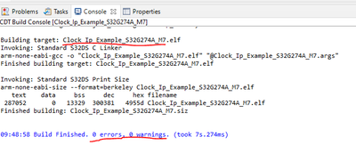

We understand that you did not generate the required code under the example. For that, you right-click under the project itself then select the following option:
Then, under configuration tools, click the following button:
It should be green prior to the generation of code and gray (as shown above) once the code has been correctly generated. From our side, we have generated the example you have provided the logs for no problem:
Please, let us know.

4,375件の閲覧回数
Daniel-Aguirre
Thanks for your feedback. For the following comment:
No, for the examples how can I do the setting tools?
