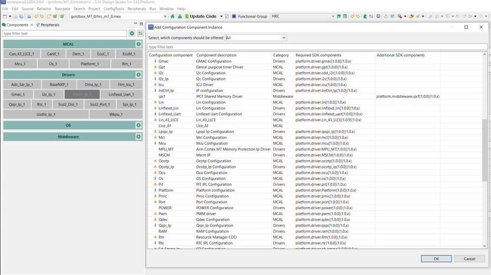

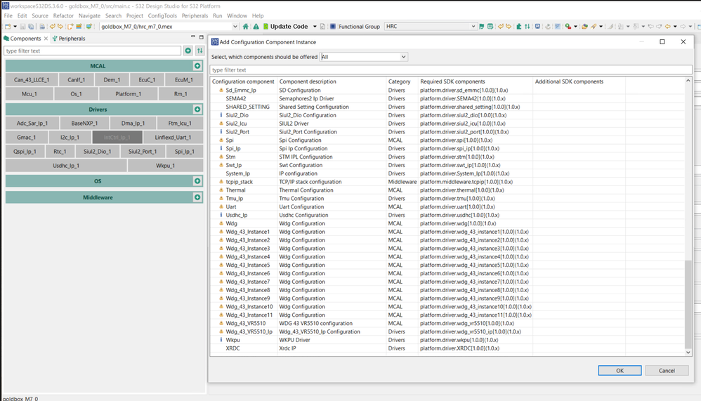

I'm trying to configure the Serdes RTD driver to be able to use GMAC with Serdes.
But when I go to the peripheral view I can't find Serdes in the list.
What is the process to add Serdes configuration to a project in Design Studio ?
I checked and serdes RTD driver is present under
C:\NXP\S32DS.3.6.0\S32DS\software\PlatformSDK_S32XX_4_0_0\RTD\Serdes_TS_T40D11M50I0R0
Thank you for your help

Hello @yanis-waabi
After some research I can conclude that there is no supported procedure to add SerDes in S32DS. If you see the examples folder of the module, you can see that there are examples only for EB Tresos.
I apologize for the inconveniences.
