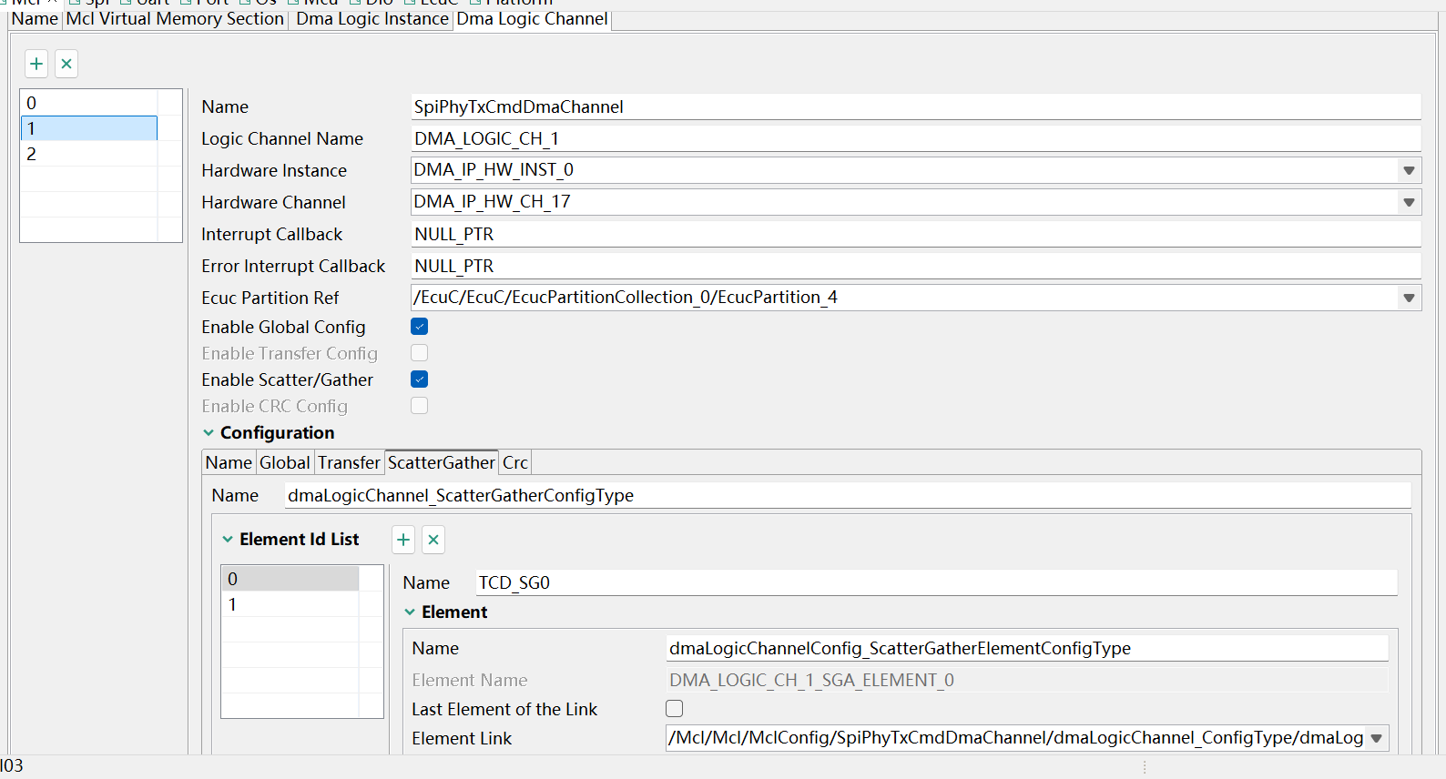

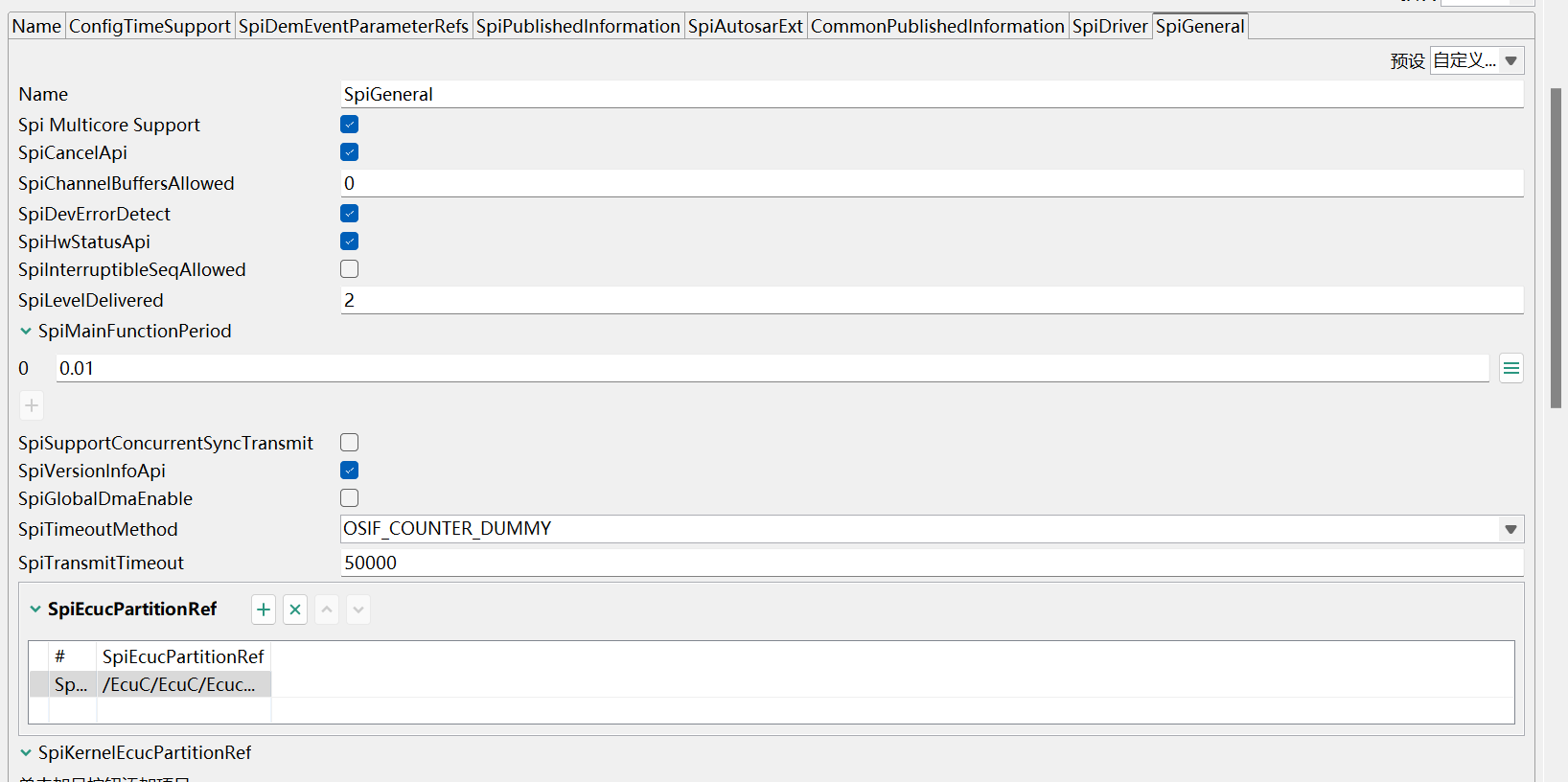

Hello, NXP engineers. Currently, I am using the S32 Design to configure a multi-core project for the S32G399A. My main intention is to test the SPI function. However, during the use process, the status of the SPI function is 'failed'. Can you confirm which configuration part has an issue?

hello, joey_z , when i run this code, the sequence is pending (what i mean is 1) and at the same time, the status of Spi_JobResultType also is pending.
I want to ask a clear question about mcl_init (), why this function can't be called in the multi-core version, but it can be called in the default spi project, and it can enter the interrupt mode normally. How should I debug it later to use the spi function in the multi-core version? As mentioned above, the current state is all in the pending state.

It should have some conflicts between A core and M core, if The mcl_init () can not use in multi-core. I checked the mcl_init () function in SPI demo, it not be use for some function. Have you added the DMA support to mcl_init ()?  Please check whether the resources conflict. Or there are different configurations for the same peripheral on multiple cores.

hello, joey_z. As u guess, I added DMA to mcl, but it worked normally in single-core mode before. The DMA of multi-core is the same as the original one, Why can't this project enter the interrupt and call mcl_init () function?

It is recommended to remove the relate DMA initial/using in Multi core. It is mothed to devoid the conflict.

hi, joey_z, thanks for u reply. At present, I have configured two spi interfaces, how to confirm which spi sent the information and how to write main.c;; At the same time, in the multi-core version, the spi function of core0 can be triggered normally, but the spi function of core1 cannot be triggered. Is it related to the interrupt and how to change it? Thank you ~

In addition, you can try to use the Mcl_Init function only one core.
