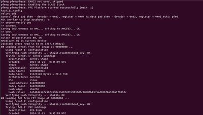

I’m working on BSP 43 and currently enabling Verified Boot via local.conf to perform kernel image verification.
However, when I attempt to load an external U-Boot script via TFTP, "tftp <filename>" the file gets loaded into the loadaddr, and then when i execute it through "source ${loadaddr}",
I encounter an error: Wrong image for source command.
The same steps when followed without verified-boot, it is successfully executed.
Any insights or suggestions on this would be appreciated.

Observations from the past few days:
  • The “Wrong image format for source command” error originates from source.c.
  • When Verified Boot is enabled, CONFIG_FIT gets enabled as well. Since my script is not in FIT format, it falls back to the default case.
  • To work around this, I forced U-Boot to read the script in uImage format, even with Verified Boot enabled.
  • I also noticed that the verify variable is automatically set to -1, causing the kernel image and DTB to boot without verification.
  • When I stopped at U-Boot and manually set verify=yes, the verification step did take place, and the image booted as expected.

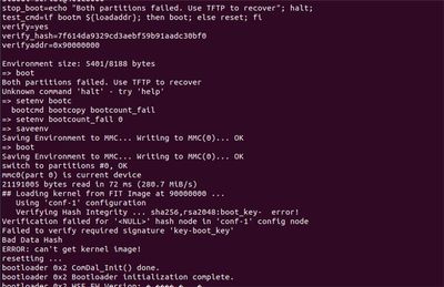

  • However, when I attempted to patch the verify variable to automate this flow, I encountered an error.
    I would appreciate your guidance on how to correctly automate this behavior within the U-Boot flow.
    manually adding verify=yes (working)
    this is when i patched verify=yes and tried to boot (It fails even when I manually set verify to yes.

I'm happy to share that I’ve identified the issue.
Yes, I am adding
DISTRO_FEATURES:append = " verifiedboot"
to the conf/local.conf file in the Yocto build directory.
The problem was that the verify variable was getting set to -1, which caused the kernel and DTB to load without verification. I’ve created a patch to set verify=yes, and perform a reset and with this change, everything is now working as expected.
