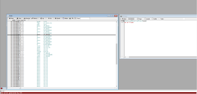

Harish_R
Hi @Joey_z
Thanks for your time.
im not actually testing manually. so trying to test via scheck module in SAF.
for info im attaching the call stack and point where i lost the control(exception).

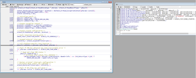

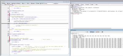

Hi @Joey_z
Thank you for the reply,
yes, as you mentioned am referring to the S32_SAF_Demo for implementation. i have integrated according. I'm also integrating the exception.c file like as done in the Demo. but unfortunately, there's a exception for multi bit error test/uncorrectable error test in SRAM. im not sure how to clear the exception.

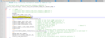

Harish_R
Hi @Joey_z
im trying to debug from my side. but the exception part remains the same. im not sure of passing this address(&sCheck_au8ReservedTcm_0[0]) in SramTest API
can you please tell me like what's the purpose of passing &ReservedTCM.  the TCM memory should be configured? for time being i have only SRAM0 test. and in eMceM i have enabled SCHECK_SRAM_ECCSTARTUPTEST_SRAM_0_ECC fault.

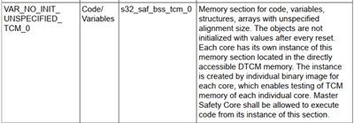

hi,Harish_R
Thank you reply and information.
Please make sure that the memory allocation complies with the prerequisites in the sCheck User Manual. The chapter 5.3.1.  In particular, DTCM should be configured as executable.

Hi @Joey_z
sorry for the delay,
i have configured DTCM memory and mapped the section(s32_saf_bss_tcm_0) to DTCM (0x2000 0000) but still the behavior is similar. there is hardfault error while sram_read fn is executed.

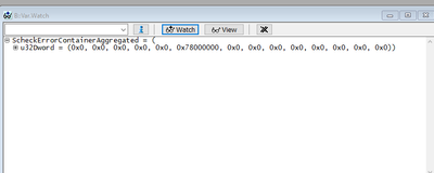

when the debugger is detached, the program runs fine. and when debugger is connected the code is stuck in stack (mapped to DTCM memory).
when it's in runtime. i have read the variable that is passed in scheck_startup test to read error ScheckErrorContainerAggregated. im observed all test are passed.
is this expected?? or the behavior with debugger is different?

Joey_z
hi,Harish_R
Thank you for your reply.
When connecting to the debugger, what value does "fail" mean to see? Could you share it? Is the observation of whether a sCheck passes or not based on the variable ScheckResultCode?

Hi @Joey_z
 that result is still NOT_OK
