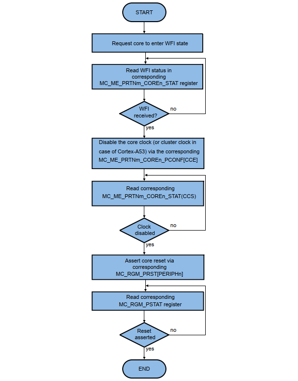

I would like to know the step by step process to shutdown A53 Core from M7 Core. Kindly send me is there any standard way of shutting down A53 core from M7.
1 返信
1,307件の閲覧回数
nxf92355
Hi Roop Pandla
Hope you are doing well
There are no information like standard way for same. you can refer from reference manual 28.12.11 Core turn-off sequence.
