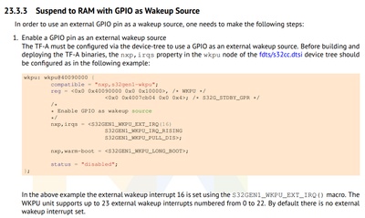

Can NXP provide register settings/steps to set WKUP21 as wakeup source?
board = NXP S32G399A-RDB3

The following information is provided under the BSP38.0 User Manual:
Don't know if it helps.
Please, let us know.

Does GPIO/Wakeup setup need to be configured by ATF, or can this be done using a Cortex-A53 EL1 driver ?
6,575件の閲覧回数
Daniel-Aguirre
Are you using any specific BSP version from NXP?
Under the BSP38.0 User Manual the following is told:
In which the modification needs to be made under the TF-A. Also, the following is noted:
"Note, however, that U-Boot is not involved in the Suspend/Resume sequence; only the TF-A is."
Don't know if this is of use.
