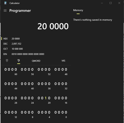

On S32G399A-RDB3 board, I am utilizing J5 pin 19 as wakeup source, labeled:
GPI[182]
WKUP21
External IRQ7
Would settings of:
WKPU_WBMSR
STBY_GPR.WKUP_PUS.B.WKUP_PUS
WKPU_WIPUER_WIPDER,
WKPU_WIREER
WKPU_WRER
= 0x00200000 ?
then set MSCR[182]:
SIUL2_0.MSCR[182].B.PUE = 1;
SIUL2_0.MSCR[182].B.PUS = 1;
SIUL2_0.MSCR[182].B.IBE = 1;
Thanks, -bill.
5,338 Views
Daniel-Aguirre
Thanks for your feedback. We do apologize, it does seem that we provided the wrong values. As you say, MSCRn should be 182:
And for the hex, it is also correct, should be 0x00200000:
Again, we do apologize for our mistake.
Please, let us know.
