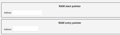

Joey_z
hi,JalseyXie
Sorry for the reply late.
Please check whether the following address is filled in correctly.
If you confirm that there is no problem with your burning method.
You can try using M or A core to check whether the content you burn to NOR FLASH is correct and see if there are any problems with your burning algorithm.
Hope it can help you.
Joey

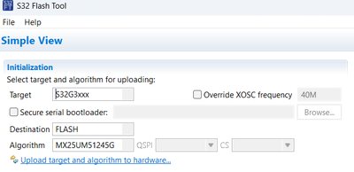

LONGGANGSU
Hello, may I ask if your issue has been resolved? The S32G399A chip I am currently using has a Flash model of MX25UW51245. My current situation is that it can be burned and verified successfully using the FLASH TOOLS tool. However, when I configure BOOTMOD to RCON, it cannot start from FLASH. I can measure the SCK and CS signals using an oscilloscope. The SCK clock is 28MHz, but it only lasted for about 1.3ms.
640 Views
JalseyXie
Hi @LONGGANGSU ,
Yes, we managed boot from NOR flash by using custom qspi paramters.
But for the nor flash you're using, you should be able boot from flash using this the algorithm in S32FT.

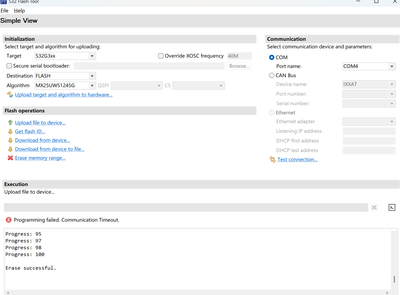

LONGGANGSU
Hello, I encountered another problem today, when burning, I can only erase it, I can't continue, help me take a look.
Reading flash id is also correct
633 Views
LONGGANGSU
I have resolved this issue, thank you.
