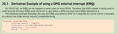

Hello, I am using the S32G399A chip. When I use the PL_03 pin as an EIRQ interrupt, how should the device tree be configured? How to handle the interruption.

For this topic, there is an example in BSP UM, you may reference it for details.
