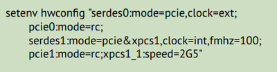

I received our customized board and used BSP41 to boot it up. The board has some modifications to GMAC and PFE configurations, which are set as follows: SGMII, SGMII, SGMII, and RGMII, respectively.
For the SERDES configuration, I used mode 1 for SERDES0 and mode 3 for SERDES1. The hwconfig was set to:
serdes0:mode=pcie&xpcs0,clock=ext,fmhz=100;pcie0:mode=rc;xpcs0_0:speed=1G,an=0;serdes1:mode=xpcs0&xpcs1,clock=ext,fmhz=125;xpcs1_0:speed=1G;xpcs1_1:speed=1G.
In this setup:
GMAC and PFE2 do not have external PHYs.
PFE0 and PFE1 are connected to external PHYs.
I made the corresponding changes in TF-A device tree. However, when U-Boot initializes, I noticed that both XPCS0 and XPCS1 are in reset, init failed. I’ve attached a screenshot for reference. Could you please share any insights or suggestions on this issue?
The PFE0 and PFE1 external PHY has not power enabled yet, so the PHY was not found error is expected.

Hello, @XD
Thanks for @jiajun_cheng 's kindly input, yes, from the log, it seems like the case we ever supported
You mentioned that both PCIE0_CLK_P/N and PCIE1_CLK_P/N are grounded, then you may have to use the internal clock to driver.

XD
Hi @chenyin_h ,
Yes, the same clock=int were applied to both serdes, only the serdes1 has not init failure any more. However, I am still working on the mdio access external PHY issues on serdes1 pfe0 and pfe1. So cannot verify these two interfaces are fully working until solve the PHY issues.
XD

XD
Hi @chenyin_h ,
Thank you for your reply.
I did not change anything on code, just modified the hwconfig, changed both serdes "clock=ext" to "clock=int"
the previous hwconfig,
current hwconfig,
serdes0:mode=pcie&xpcs0,clock=int,fmhz=100;pcie0:mode=rc;xpcs0_0:speed=1G,an=0;serdes1:mode=xpcs0&xpcs1,clock=int,fmhz=100;xpcs1_0:speed=1G;xpcs1_1:speed=1G
and here is the new log after applying the nxp-s32cc-xpcs.c change. However, I don't think that function was executed. I have printf in the code and patch it to bb file.
=> setenv hwconfig "serdes0:mode=pcie&xpcs0,clock=int,fmhz=100;pcie0:mode=rc;xpcs0_0:speed=1G,an=0;serdes1:mode=xpcs0&xpcs1,clock=int,fmhz=100;xpcs1_0:speed=1G,an=0;xpcs1_1:speed=1G,an=0"
=> save

4,798 Views
chenyin_h
Hello, @XD
I remember that the "clock=int" should be available, and according to the UM, the following hwconfig could be seen:
Would you please help to share more logs for the setting issue you met?  (also BSP version used)
Chenyin
4,781 Views
XD
Hi @chenyin_h ,
We are using bsp41, here is the log after changing to the new hwconfig.
XD

hwconfig=serdes0:mode=pcie,clock=ext;pcie0:mode=rc;serdes1:mode=pcie&xpcs1,clock=int,fmhz=100;pcie1:mode=rc;xpcs1_1:speed=2G5

Hello, @XD
Chenyin
4,813 Views
XD
Hi @chenyin_h ,
Thank you for your input.
How can I make the change to use the internal reference clock? I tried changing the hwconfig from clock=ext to clock=int, but it didn’t help. It seems like the U-Boot code only recognizes the ext keyword. Maybe I missed something. Do you have any suggestions?
XD
4,877 Views
jiajun_cheng
Hi, @XD :
I have also been debugging our custom board recently, although the interfaces used are slightly different, I only used (gmac0 & pfe2) I also encountered the same log.jiajun_cheng_0-1737005629254.png
In our hardware, it was caused by the routing and PCIE0_CLK_P. So I suggest you look at the hardware reasons first:
1. Is the serdes clock 125/100mhz
2. Is the power supply normal
4,828 Views
XD
Hi @jiajun_cheng ,
Thank you for you suggestions.
According to the schematics, both PCIE0_CLK_P/N and PCIE1_CLK_P/N are grounded. Does the XPCS share the same clock as the PCIE? If so, is it possible to use the internal reference clock to feed into the SERDES instead?
XD
