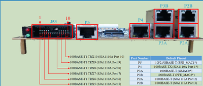

Does The NXP S32G399A-RDB3 development board include a built-in cellular modem or Network Access Device (NAD)?
If not, does it provide expansion options to add one?
1,021 Views
chenyin_h
Hello, @MohamedAbdelslam
Thanks for the post.
The RDB3 provides the following network connectors, but not including built-in modems.
There are M.2, PCIe, USB, etc. exist on the RDB3, from my experience, devices like WIFI module, LTE/5G module could be connected to the board.
