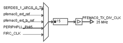

We have a custom S32G399A board that uses PFE0 in RGMII mode to a gigabit transceiver (KSZ9131) wired to a RJ45 plug.
The hardware works fine when connected to a gigabit switch or router however when connected to a 100BASE-TX router the PFE0 TX clock does not get set to 25MHz and remains at 125MHz which is the speed for gigabit.
After some investigating I can see that the pfe0 tx clock comes from these two muxes:
EMAC0 mux
CGM2 Mux 1 with divider. Setting this divider to this value (5) is what we need the kernel (and SCMI I suppose) to be able to do.
The pfeng driver seems to think it is setting the clock to 25MHz
however probing the physical pfe0 tx pin shows the old 125MHz clock and there is no ethernet traffic passing through.
I believe SCMI running in BL31 (part of TF-A) is responsible for clock management.

The shell clearly outputs that the mux is being enabled with the divider set to 5 however this doesn't seem to work.
I have found a temporary workaround of just setting the PHI5 output of the peripheral pll to 25MHz via this patch which does work and enables 100Base tx communications
diff --git a/fdts/s32cc.dtsi b/fdts/s32cc.dtsi
index 15ee06089..d8177c12b 100644
--- a/fdts/s32cc.dtsi
+++ b/fdts/s32cc.dtsi
@@ -428,7 +428,7 @@
<S32GEN1_PERIPH_PLL_VCO_FREQ>, <100000000>,
<80000000>, <80000000>,
<125000000>, <200000000>,
- <125000000>, <100000000>;
+ <25000000>, <100000000>;
accelpll: accelpll@40040000 {
This isn't ideal since we might have other things reliant on the PHI5 clock that need a different frequency. The divider of CGM2 Mux 1 seems like an easier thing to modify.
