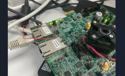

On EVB3, you may try the following:
1. Plug the network cable to the the following interface:
2. Once booted, before transfer the image, set the default interface to eth0
3. Try transferring the image from your PC to the EVB3 via the tftp service.
I hope it will help.
Chenyin
