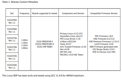

Hi @XD,

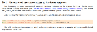

The BSP41 User Manual says that configuration is available, but in my workspace, I was only able to see it at the secondary kernel of BSP41.
[Page 160, Linux BSP 41.0 User Manual for S32G3 platforms]
[Page 2, Linux BSP 41.0 Release Notes for S32G3]
Try to enable it using the secondary kernel of this BSP version (to debug purpose). Then with this you can try the configuration of the PPS register, after that you can develop a kernel driver to write the desire values to the registers.

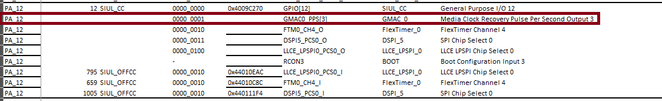

You can locate the needed information to the configurations at the S32G3_IOMUX.xls file attached to the S32G3 Reference Manual.
As you can see GMAC0_PSS[3] is the option 0000_0001, so at the device tree we need to configure that pin as FUNC1
In this example I will use as reference the S32G RDB3 board.
So, I modify the file s32g399a-rdb3.dts with the following:
&gmac0 {
    pinctrl-names = "default";
    pinctrl-0 = <&gmac_out_pins>;
    status = "okay";
&pinctrl {
    gmac0_out_pins: gmac0_out_pins {
        gmac0_out_grp {
            pinmux = <S32CC_PINMUX(12, FUNC1)>;
            output-enable;

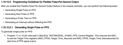

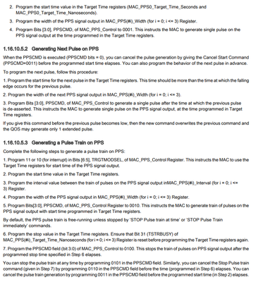

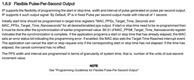

carlos_o
Hi @XD,
The internal team want to know how you are trying to configure the PPS registers.
Also, they recommend review the following information:
[Page 811, GMAC Subsystem RM, Rev. 2, 02/2023]
[Page 905, GMAC Subsystem RM, Rev. 2, 02/2023]
[Page 906, GMAC Subsystem RM, Rev. 2, 02/2023] 

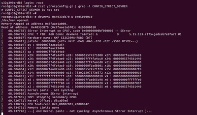

I attempted to use devmem2 to modify the MAC_PPS_CONTROL register (0xB70), specifically the ppscmd and enable bits. However, this caused a kernel panic. I’ve attached a screenshot for reference.
Could you advise on the correct method for reading and writing GMAC registers?

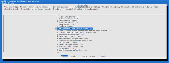

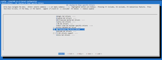

carlos_o
Hi @XD

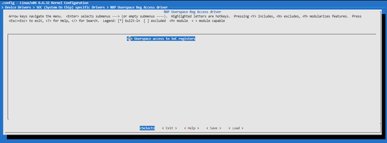

devmem2 is not supported for the registers that has a write protection. If you want to access those registers from user space, you can do the following:
Invoke the kernel menuconfig
If are working with a Yocto build the command is:
$bitbake virtual/kernel -c menuconfig
If you work with the manual build from your linux repository the command is:
$make menuconfig
then go in --> Device Drivers --> SOC (System On Chip) specific Drivers -->NXP Userspace Reg Access Driver
and select:
<*>Userspace accessto soc registers
as below:
Rebuild the kernel
If you are using yocto deploy the image.
The you can either reflash the full image or just replace "Image" in the "boot_s32g3" partition of your SD card / eMMC.
With this new image at your userspace you can write on the register as following:
root@s32g399ardb3:~# echo 0x4009C24C 32 0x00123000 > /sys/kernel/s32cc_regaccess/write
this is as
echo [register_address] {access_width} [register_data] > /sys/kernel/s32cc_regaccess/write
for read register you can also use this without the register_data writting an echo to /sys/kernel/s32cc_regaccess/read

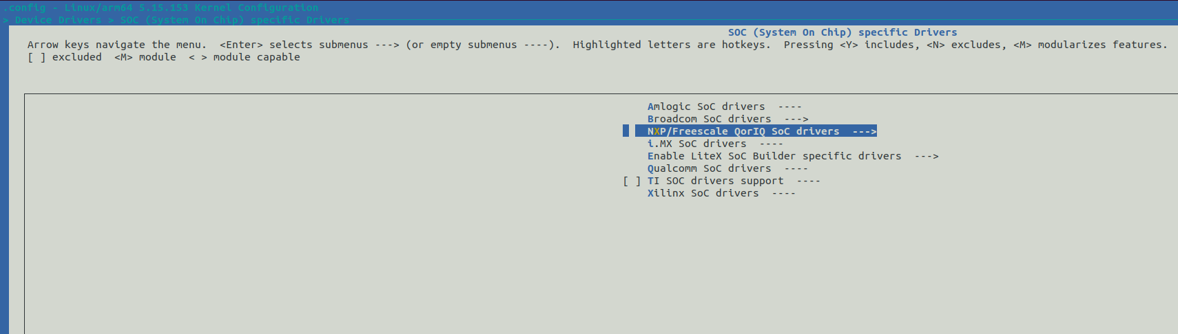

XD
Hi @carlos_o ,
Thank you for the detailed instructions; this is exactly what I need.
Unfortunately, the kernel I built using bsp41 Yocto is version 5.15, and there is no 'NXP Userspace Reg Access Driver' under 'SOC (System On Chip) specific Drivers.' I have attached a screenshot. Is there a way to enable it with the 5.15 kernel?
XD
2,760 Views
carlos_o
Hi @XD,
