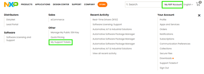

If you are not comfortable sharing information in this public post, you can open a private support ticket from the NXP main page:
