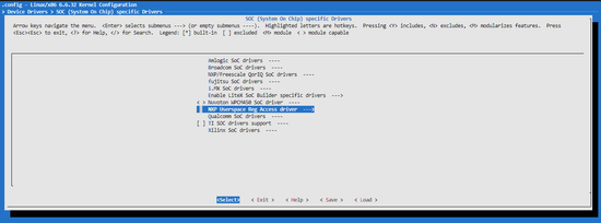

Hi @XD
devmem2 is not supported for the registers that has a write protection. If you want to access those registers from user space, you can do the following:
Invoke the kernel menuconfig
If are working with a Yocto build the command is:
$bitbake virtual/kernel -c menuconfig
If you work with the manual build from your linux repository the command is:
$make menuconfig
then go in --> Device Drivers --> SOC (System On Chip) specific Drivers -->NXP Userspace Reg Access Driver
and select:
<*>Userspace accessto soc registers
as below:
Rebuild the kernel
If you are using yocto deploy the image.
The you can either reflash the full image or just replace "Image" in the "boot_s32g3" partition of your SD card / eMMC.
With this new image at your userspace you can write on the register as following:
root@s32g399ardb3:~# echo 0x4009C24C 32 0x00123000 > /sys/kernel/s32cc_regaccess/write
this is as
echo [register_address] {access_width} [register_data] > /sys/kernel/s32cc_regaccess/write
for read register you can also use this without the register_data writting an echo to /sys/kernel/s32cc_regaccess/read
3,846 Views
XD
Hi @carlos_o ,
Thank you for the detailed instructions; this is exactly what I need.
Unfortunately, the kernel I built using bsp41 Yocto is version 5.15, and there is no 'NXP Userspace Reg Access Driver' under 'SOC (System On Chip) specific Drivers.' I have attached a screenshot. Is there a way to enable it with the 5.15 kernel?

carlos_o
Hi @XD,
The BSP41 User Manual says that configuration is available, but in my workspace, I was only able to see it at the secondary kernel of BSP41.
[Page 160, Linux BSP 41.0 User Manual for S32G3 platforms]
[Page 2, Linux BSP 41.0 Release Notes for S32G3]
Try to enable it using the secondary kernel of this BSP version (to debug purpose). Then with this you can try the configuration of the PPS register, after that you can develop a kernel driver to write the desire values to the registers.
