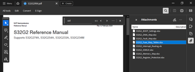

We understand that the UID is put into the FUSEs available under the S32G platform. To be able to read them, S32G2 provides an OCOTP peripheral [Page 3358, S32G2 Reference Manual, Rev. 8, February 2024]. The Fuse Map of the S32G2 is embedded under the S32G2 Reference Manual by the name "S32G2_fuse_map.xlsx":
