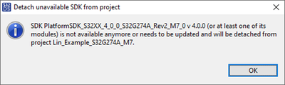

Trying to build and run the S32G274A_Integrate LLCE_CAN_LIN example, following all instructions in the document and due to probably outdated something (some clock divider was not suitable) - I had to run the configuration tool - and here comes the problem
After updateing code in the configuration tool, I saw that the generated files are not generated in the suitable RTD version, they are RTD 3.0.2 as long as the example is RTD 1.0.0
And as so, the compiler says that the versions are different.
see one example for OsIf.h and OsIfCfg.if

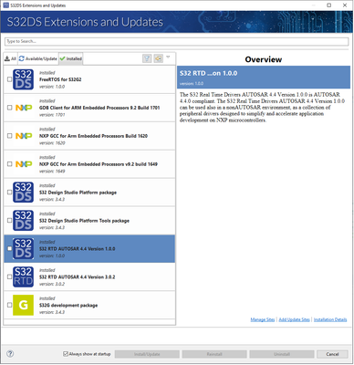

My S32DS is installed with two RTDs , 1.0.0 as this example requires and 3.0.2 as come with the S32DS
How should i make the configuration tool to generate (update) the code according to a RTD version i want ?

A project is linked directly to the packages it was made with. You could try to detach and try to attach a new package, but it will either fail or even create problems on the project.

We apologize for the problems you are having. We understand that the guide/project you are using is outdated at this moment, and that still we have it published in our site, we apologize.
Seems to be that the general problem is that the example was created using RTD v1.0.0 while S32DS is taking your RTD v3.0.2. Did you install RTD v1.0.0 prior to importing the project? If not, the project automatically took the RTD version you had installed.
Even after you installed RTD v1.0.0, if the project took RTD v3.0.2 by default, you need to delete the project and import it again. You need both RTD/LLCE for this project to work, do you also have an LLCE version that works with RTD v1.0.0?

After many tries I must say that the S32 is 'unwilling' to upgrade or downgrade (i.e., migrate) a project from the RTD version it was created to the one installed in the IDE/
Even an example project loaded to the IDE under an underlying RTD, and after which another RTD was installed, the project fails and can't be fixed until its uploaded / created / imported once again with the new RTD
