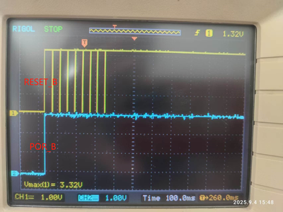

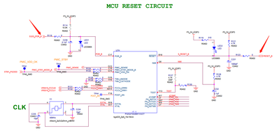

I use S32G2 and its PMIC (VR5510) ,Refer to the S32G-VNP-RDB2 scheme.
The voltages are correct.
But the S32G2 does not work
The system image is in the TF card, and LPDDR is not installed yet
What could be the problem?

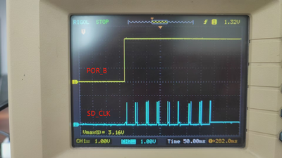

1. You are willing to booting the board via SD, is it right? if yes, also measure the clock of SD
2. From the wave you captured, seems there is abnormal pull-down signal on RESET_B.
3. If confirmed no issues from HW, use the debugger to attach to the board for further analysis.

    Yes,I am willing to booting the board via SD,The captured waveform is as follows.
2. There is no pull-down HW setting on RESET_B.

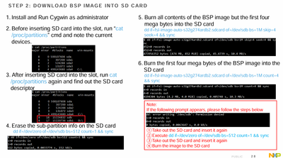

What kind of the image on the TF card? how they are generated?
Chenyin

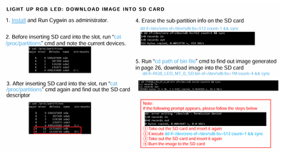

the image on the TF card  is made by the installation instructions, the following two, are the same problem.
1.
2.
