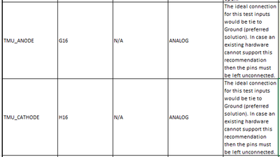

As for the TMU, this is the recommended connection for TMU test inputs, as shown under the checklist:
If more information is required on regards of the TMU, we can recommend looking into the Chapter 59 of the S32G2 Reference Manual [S32G2 Reference Manual, Rev. 7, February 2023].

It is noticed that, RDB2 schematic, the TMU pins (G16, H16) connected to ground through 0Ohm resistor.
Please help me for application circuit for connecting the sensors (3 Sensors) and type of sensor.
