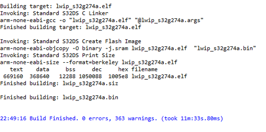

viswa_kondapall
Hi Mayank,
How you doing. Thank you for the reply. Today morning only we figured out.
1. 3 files - devassert.h/platfrom_types.h and platformtypes.h these need to place in RTD folder.
2. RTD 1.0.0 need to be added then pfe_demo is compiled.
3. 373 warnings were there. in that 10 warning are from Include parths from stacks folders were not available.
4. test setup configuration were missing.
Finally Pfe_demo is compiled but Ping is not happening. 1.3 TCP/IP stack NXP example project description is mentioned IPV4 setting.
